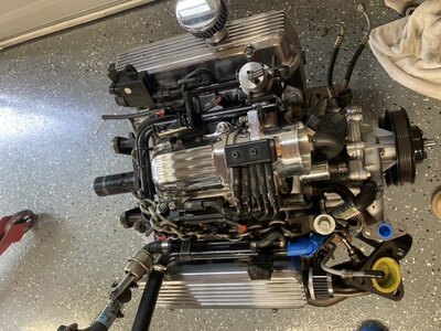

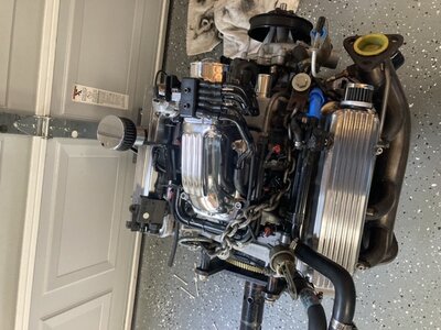

I Wet Sanded mine with 400 up to 2000 then Polished a bunch of times with White Diamond Metal Polish.I think they came out pretty good I get a lot of Comments at Shows.

Glass beads were used to get the finish in this pic. Outside only as Anthony mentioned. I used a very fine glass bead which smoothed the surface which helps when cleaning. A rag with some brake cleaner cleansing them right up. The previous owner painted the intake, plenum, and valve covers a grey color that was turning yellow. I prefer the raw aluminum look.
Forgot to mention I used 400 grit emery with a sanding block to shine up the ribs. Dawn dish soap with water to lube while sanding.
