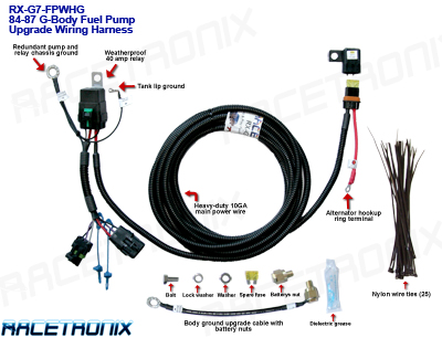

    Most of the TR senders are in very bad shape so perhaps you may consider a new SS sender with upgraded wiring to avoid any headaches (i.e. melted motor):
    [IMG]
    Add our HW harness with 10Ga Wire here:
    [IMG]

    Offline
    ^^ This is exactly what I bought from Racetronix and have been trouble free. VERY nice parts and harness is also superior like said above.
