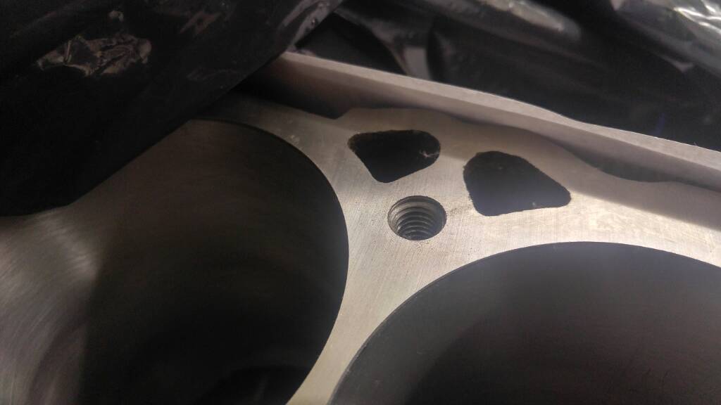

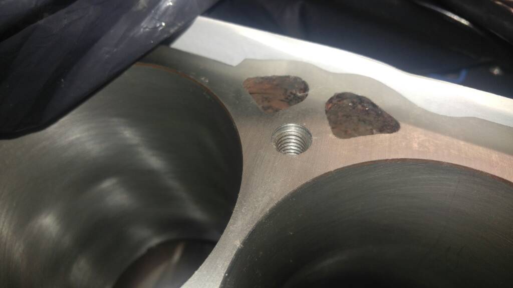

Well my block deck was machined to get it square but it's not a mirror finish. I can see the machine tool marks. I don't know what 50RA looks like but my heads are straight from Nick / porter and the deck is very smooth. What process would somebody use to try to finish lapp these surfaces? Would a long piece of glass do it with 800 grit and wd40? What's the process

Can you snag a fingernail on the marks?
I used a diamond stone to highlight any tool marks. Draw a line across the surface with a sharpie and hit it was a stone or some glass. Whatever marks are left will look waaaaay worse than they really are. You'll probably die of old age using WD and 800 grit.
I did have a slight advantage since I was doing the machining myself so I was able to screw with feed and speed while I was shaving.

Without flash
With flash
Snag a fingernail...no, but going against the tool marks you can feel the "vibration". My heads feel like glass going across them with my fingernail. I'm guessing the block deck isn't good enough.

Edit: pictures suck because website is compressing the hell out of the file.
