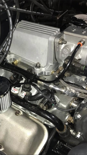

Hi Ttypewhite
I know this is an older thread, but was wondering if you have a picture of where you get the feed for the map sensor on the boost leash . It mentions pre throttle body in the instructions. I was trying to look at your pictures but they are not available anymore.

I take it from the compressor housing of the turbo.
Ok, so if you feed the map sensor with the compressor side of the turbo, where do you get the feed for the bottom part of the wastegate?
Intake manifold. Do you not have these instructions?
Intake manifold. Do you not have these instructions?View attachment 350798
Yes I do have the instructions. If I understood the instructions properly, you need to feed the bottom of the wastegate with the port from the turbo and feed the map sensor from a port before the throttle body. Not recommended to feed both map and bottom of wastegate with the same port. I’ve been getting informed and will feed my map sensor like in the picture I sent you.
