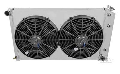

At $330 this one is slightly more expensive, however, it has the built in trans cooler (no oil cooler though). And it has dual 12” electric fans with custom fit aluminum shroud as well.

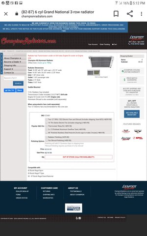

This champion radiator is a direct fit for our cars, has both coolers.
