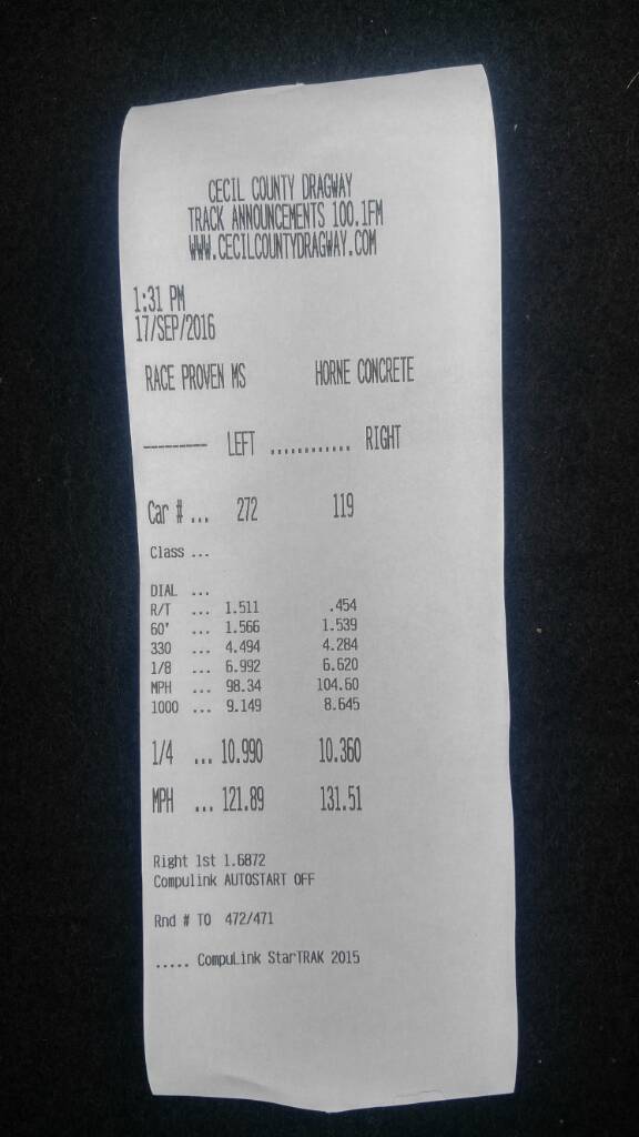

I broke a 10.99 @ 122 with a gen2 6266 S cover. Unopened longblock. 93/meth 36ish psi boost (maxed out 3.5 bar) although I really didnt pick up much power the last few psi and I believe because the engine was above its power peak. 17 blade PTC which wasnt tight enough. Flash stall around 5150rpm and I was shifting into 4th. Obviously not a ideal set up but breaking into 10s with 93/meth on my unopened longblock was my goal and I got it. Now I'm building a 4.1 which will be quite a different game with race ported TA SE heads, etc [emoji4]

achalmersman, just curious, what 60' were you running on the 10.99 pass? Were you leaving on a lot of boost? Trans brake?
I'm in the mid 11's with a 60 and stock block unported heads, home built trans with Husek LU. Trying to get my 60' lower.....aren't we all :D

Ive had a 1.54. Im not a very experienced track driver. I believe using the alky disable feature during 2step would help my 60. Foot brake, I believe about 5psi but not totally sure. TR6 2 step.
