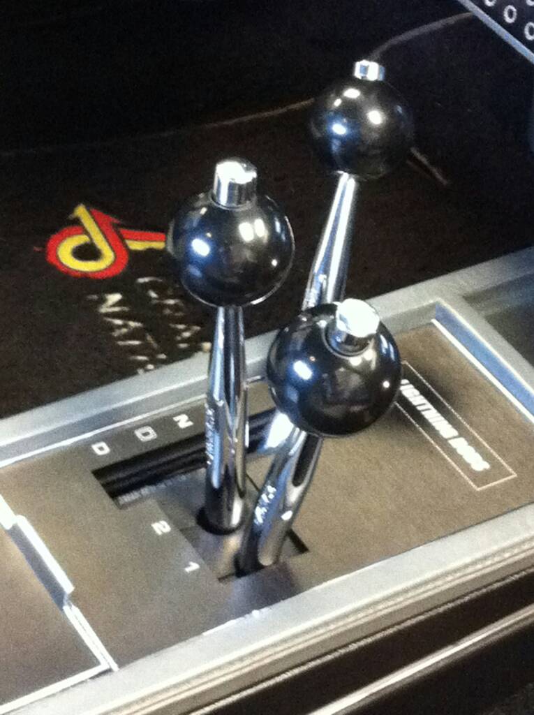

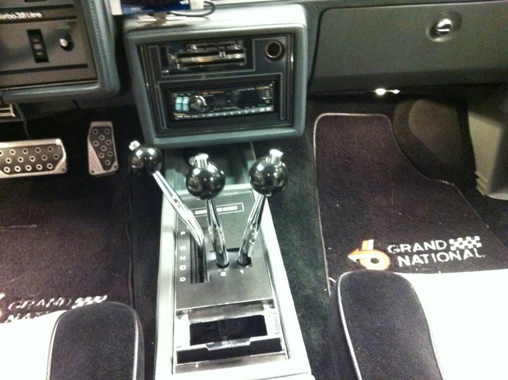

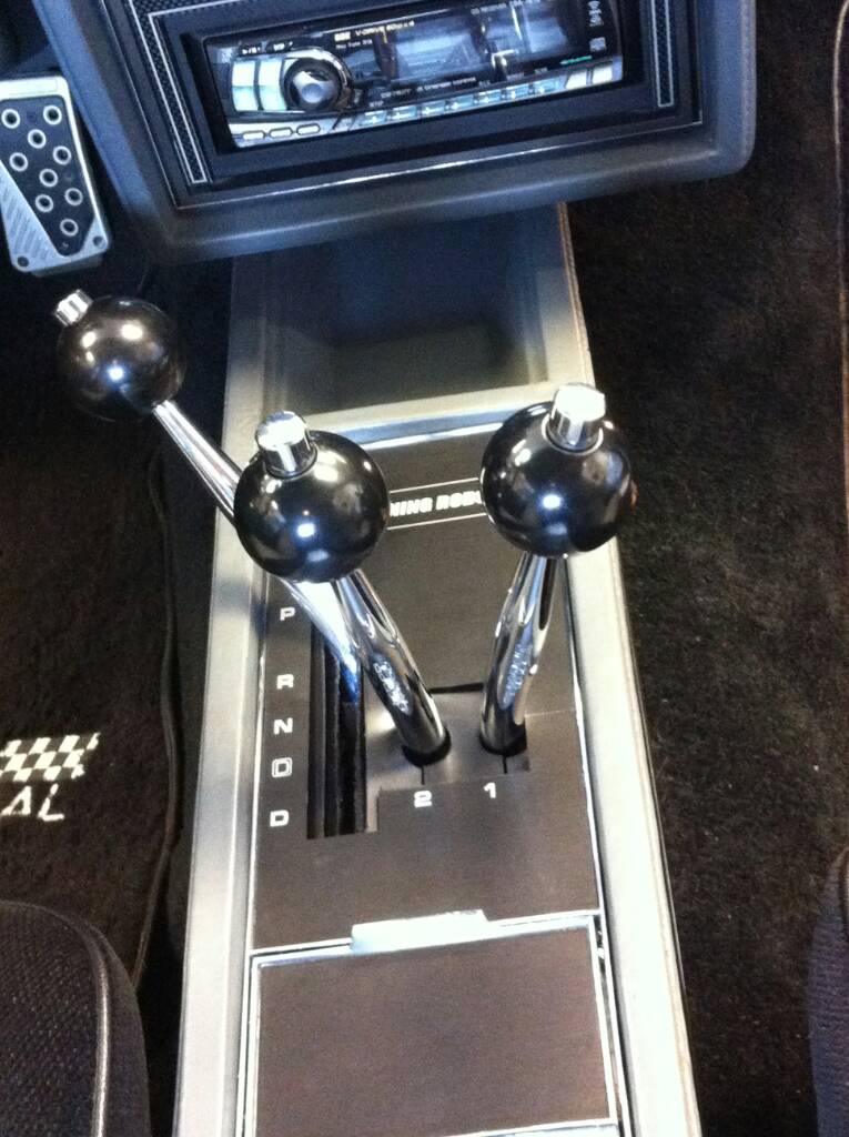

don't have pictures of when I installed them. Cut the original shift plate to clear the rods. Made my own rubber wiper gasket. Used door sweep for the bristles sweep along the main shift rod. The shifter came with all the old's mounts bolted right in. Found a old's shift cable on ebay for i think less than $60. G body parts was working on some lighting rods and parts could look there.
Got the overlay from tr custom parts in the Olds section.
