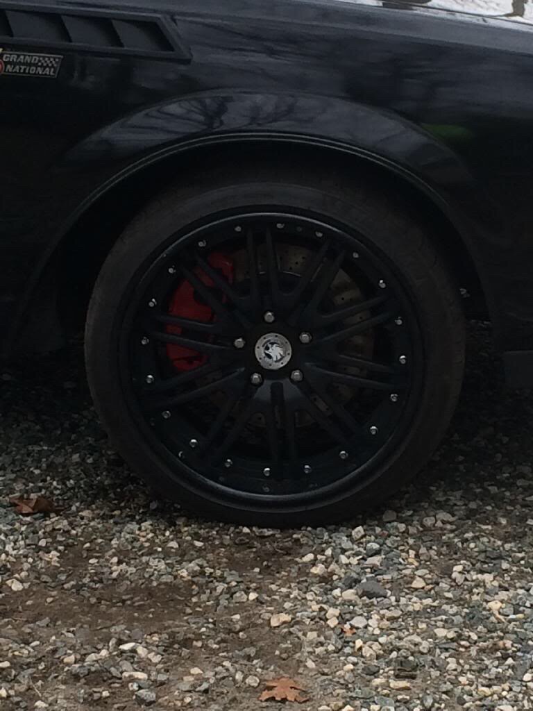

And while we are at it, this is the Blazer dual piston se up with cross drilled / slotted rotors with 18" wheel
