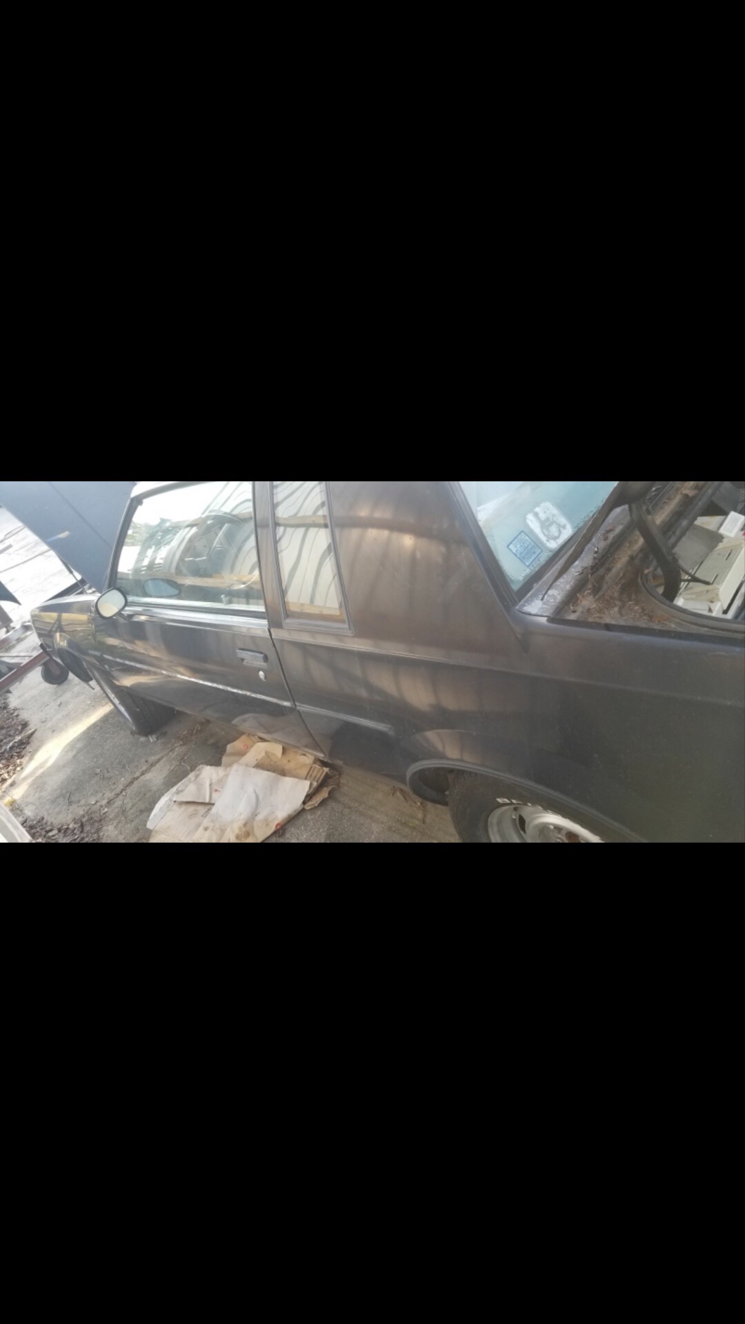

I’m not new to these cars as I have an 86 high 9-second Anderson built car. Having said that I am trying to make sure I am on the right path with this new car I’ve picked up.. it looks rough in the pictures I’m posting but the back story will help. It was an elderly handicapped couple that put right at 100k miles on it. It was bought in my town and serviced here it’s whole life.. the couple died in 98.. the car was driven around the neighborhood for a good bit (10 years). The family made sure it moved around over the years so it didn’t go to waste but then they sold their estate.. the son kept the car at that point (2011). The car was put in their garage until 9 months ago when he too passed. Since then it has sat outside in harsh weather... I cannot get over how original this car is... 1 owner and absolutely not 1 thing other than battery and wires have been changed on this car..here are my questions...
How rare is the we4?
What is a fit value of the car?
Were they low optioned cars like this?
What do I do for now with the lacquer paint?
What would make the car not even click over when you have a strong battery?
Congrats on your purchase! It sounds a bit like my Turbo T Limited I bought about 6 months ago which had been sitting for 17 years. I finally got it up and running, smogged (yep I live in CA) and registered. It's been a really big project even though I'm well versed in these cars.
To answer your questions the best I can, although many think a WE4 is a rare piece truth be told they are just black Turbo Regals with black bumpers. The one you bought looks like it needs a bit of love. I'd hope you didn't pay more than about $4k for it. As far as being low option cars it depends if that's what the original owner wanted but I don't think they have any more or less options than any other TR on average. If the car won't turn over with a strong battery like you state I'd start off by pulling the plugs and spraying WD40 or something similar in the cylinders then attempt to turn the motor over by hand and see what happens.
Good Luck
P.S. As far as the lacquer paint goes you can't do anything with it other than repaint it unless you like "patina". My Limited suffers from the same thing and I'm on the fence as to whether to paint it or not.

Everyone likes to say how rare WE4 cars are, all Turbo Regals are low production compared to Mustangs, Camaros etc. At the end of the day they are no lighter than an '86 T Type with the same options. The only thing available on a WE4 you can't get on any other Turbo T or T-Type is the black bumpers.

No hood ornament so just the header panel will be worth more than an '86 T in a few years. :p

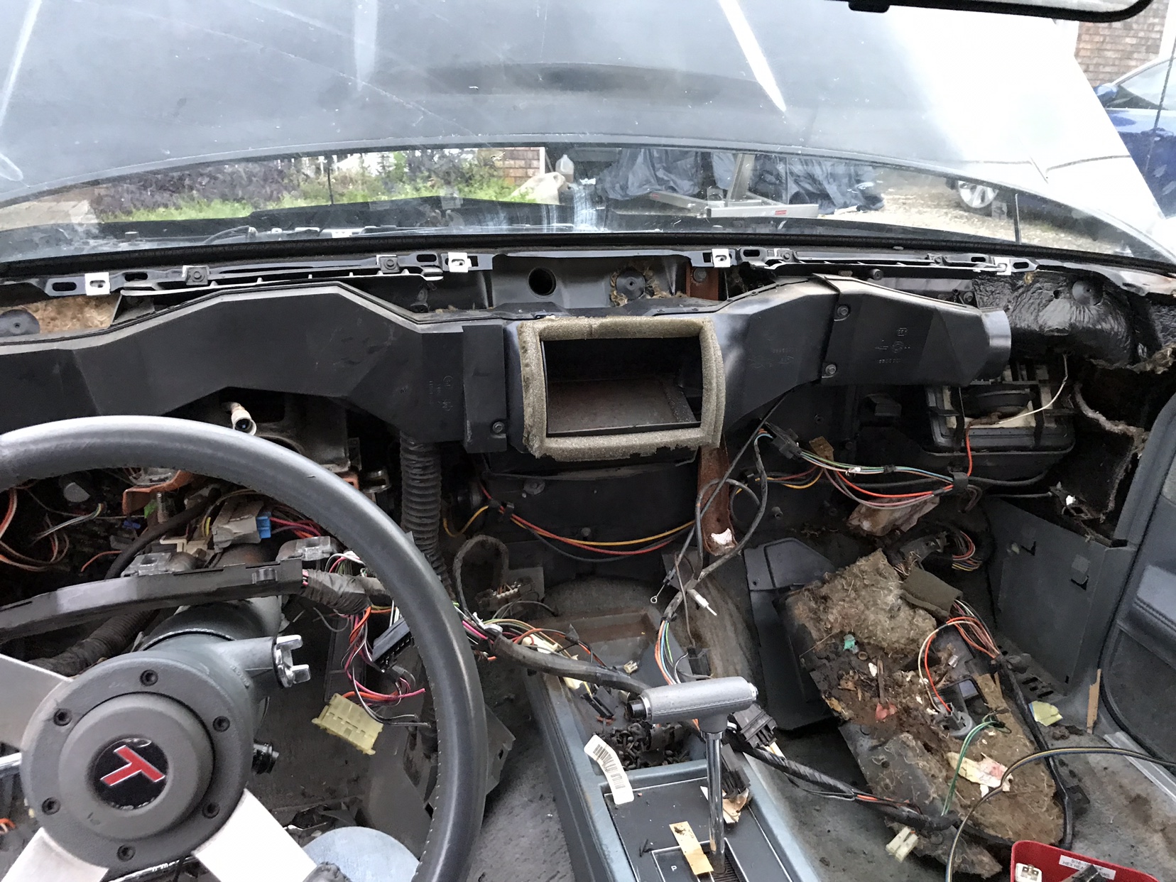

A little update... I pulled all plugs after getting the time... I put some penetrating oil in the cylinders... two days later I put a wrench on the alternator and gave it barely any movement... it turned right over no problem... since then I’ve changed to a stealth pump, Hotwire, new fluids throughout, radiator, lt1 maf and translator, 60lb injectors, new vacuum lines, and compounded half of the car.. I was able to verify miles at 30k as well!

Well.... I don’t know how this thing was running so well... needless to say... I’ve got my work cut out for myself.
Damn rats!! Wow! What a mess! At least you know it runs and man it is looking much better!! Good luck with it - keep us posted.
