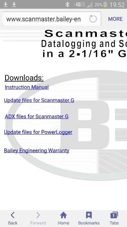

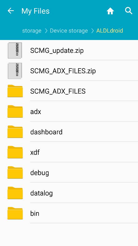

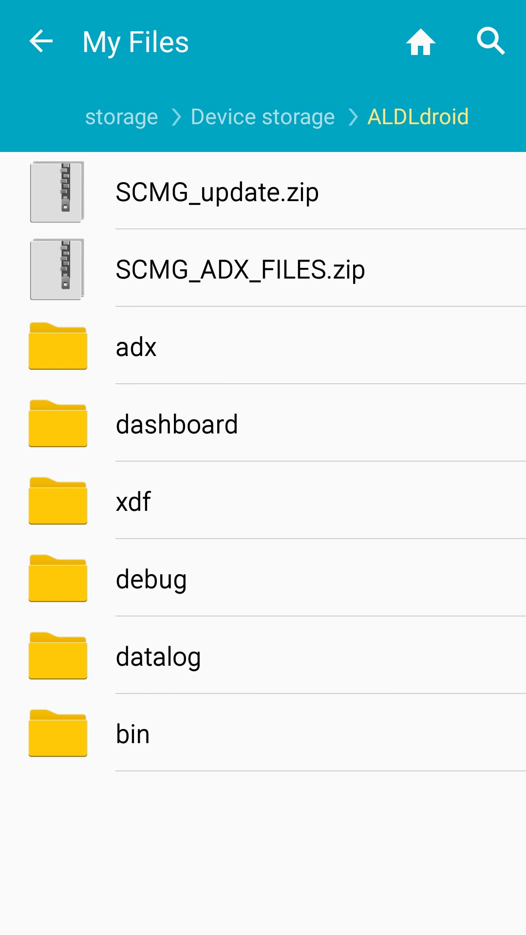

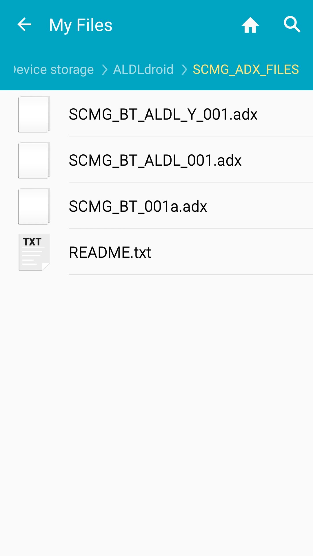

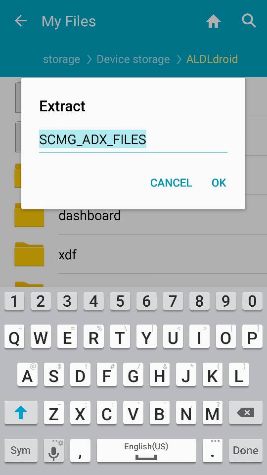

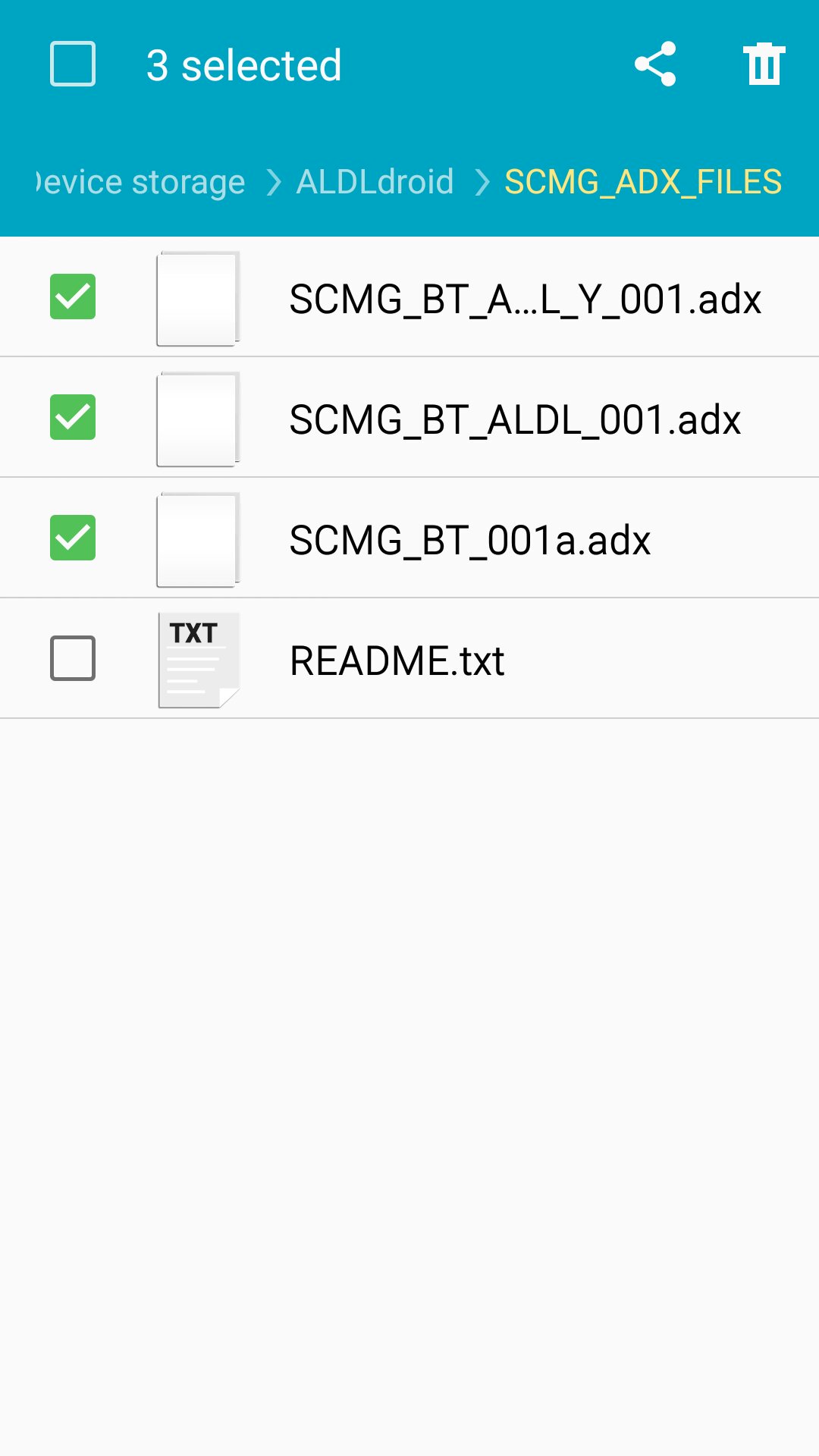

Heres a few screen shots in the basic order as above with my samsung note 3. Last pic is of the files you want to move into the adx folder. If you have been jacking with this for a while, you may need to reset the datastrean in the app settings. Hope this helps.
