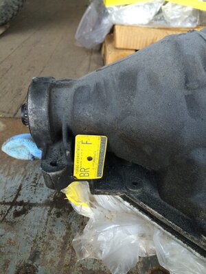

and if you want to get technical the BRF tag in turquoise (86) or yellow tag (87)

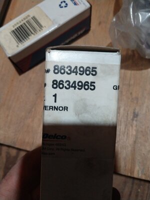

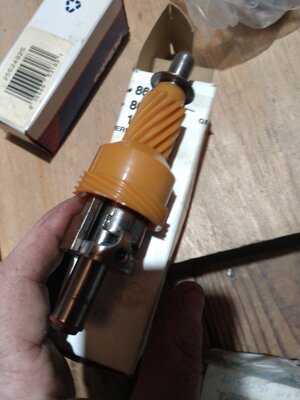

Governor which should have an orange gear for the 3.42s

colors for GN tags...but not always true...LOL
blue /turquoise(84/85)
pink (86)
yellow (87)
a brf will usually have pink paint on the valve body...stamped BR on it...

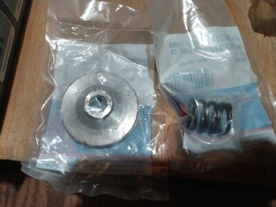

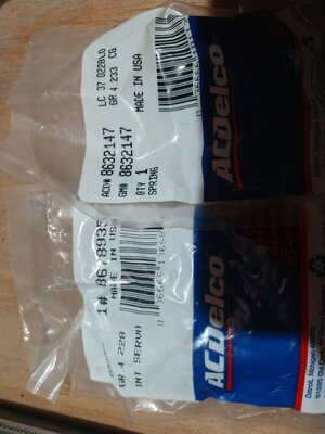

Servo piston and spring
