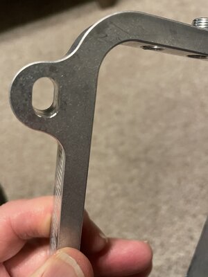

👍 Cruz Angled Plenum Spacer
I have the short thinner style (1” transitioning to 1/2”) but he offers a thick one that you’d probably be interested in
What hardware do you usually use with the spacer? I assume the stock bolts are way too short at that point.
Pretty sure the fastening hardware comes with the spacer . You’ll need a pair of dog house gaskets though

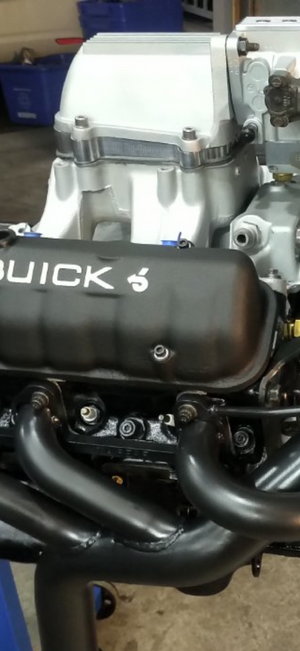

Cruz makes good stuff Do you re spot face the Dog house bolt hole the keep square with the bottom manifold?
Nope they just bolt on through an elongated spacer hole.
Bolts up nicely
