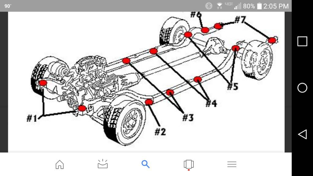

Hi,
I please wondered if anyone could point me to a "tutorial" (or the like) with the method one uses / amid the "tricks" (and ADVICE), in replacing my body biscuits on an 87 "G" Regal. WHO makes / has the best "kit" as near to O.E.M. / or is the after mkt. better ?, wheres the "sweet spot's" to PB Blast the cage nuts and get them good an soaked in the back, and under the rear seat ... *(so I'll at least have a chance in getting the bolts out) ... "that kinda thing".
ANY counsel or advice is appr. !! *I've seen a kit by "energy" (the 4141), is that a good "fit" ? .... AND: IF yes: why are these avail. in in diff. colors & just not "black" ??.
THANKS FOR ANY HELP !!

You will also want to purchase the new bolt kit from kirban as well.

Thanks !! ... SO: the "Energy Kit" (for considerably less $ amid all the hardware / like), ISN'T the way ta go then I take it ?.
I LOVE Kirban's stuff, ... "so don't get me wrong" !!!. ;)
