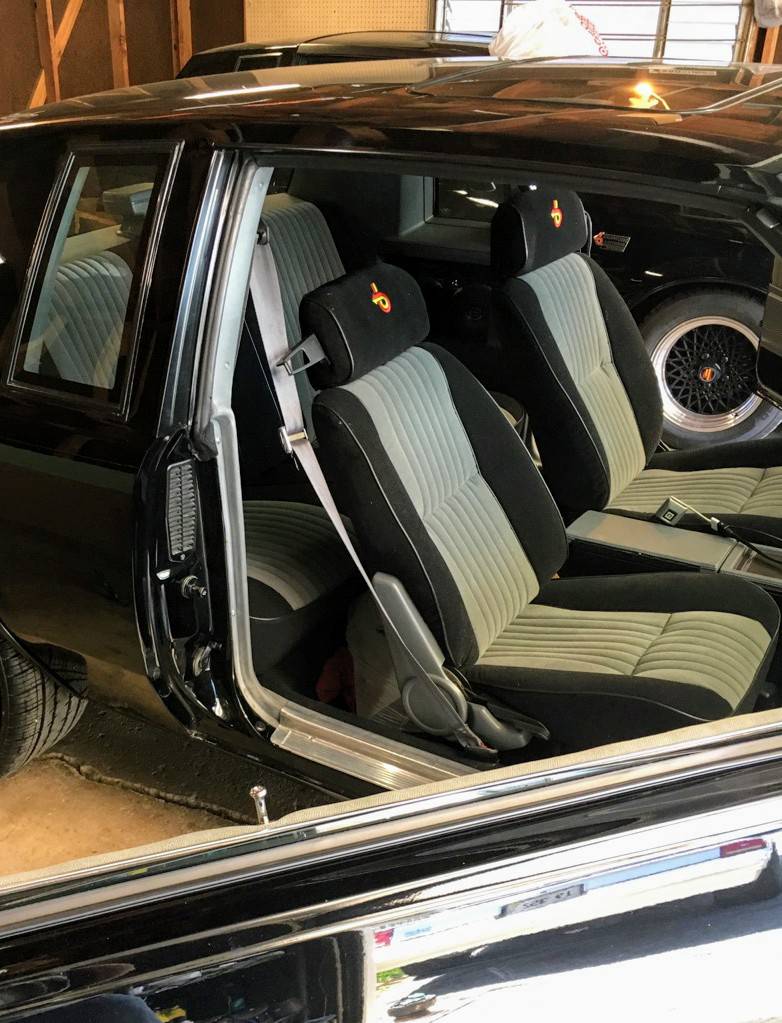

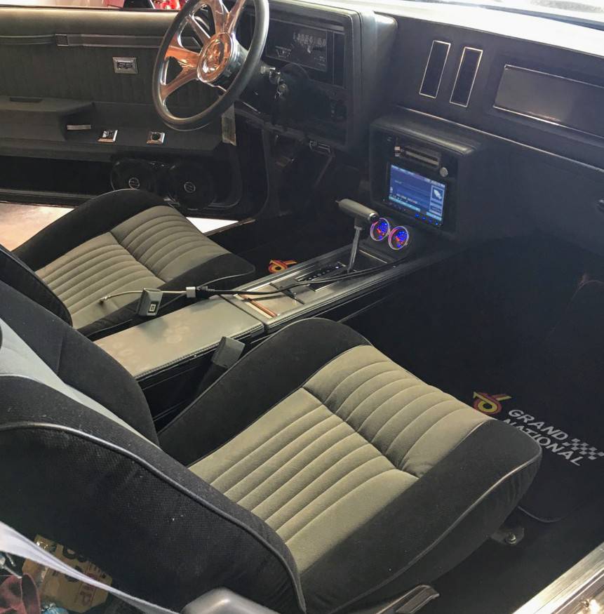

I just did everything in highway stars exclusive and am blown away every time I look at it. Extremely satisfied. I did the front and rear seat covers, door panels, and the little panels by the rear seats. The grey portion of material is a little darker than factory, but I think it looks much better as it's a closer match to the grey interior components like the dash, pillars, 1/4s, ect...

Did you get the Exclusive version from highway?

I like the Highways stars exclusive material very nice. After I saw the new Gbodyparts seat covers I was blown away how nice they were. Definitely recommend since they are the best material out there.
