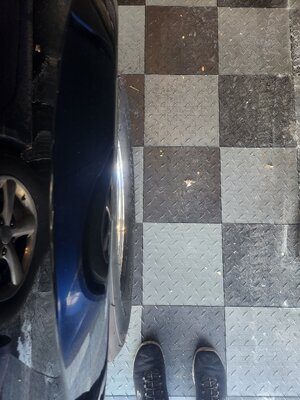

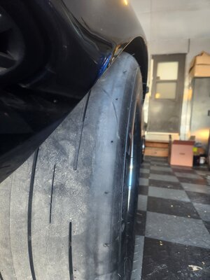

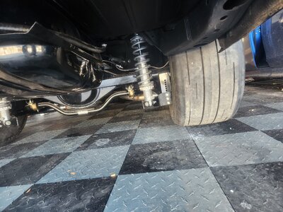

Finally getting some real time on these new 325/50/15 MT Street R tire, Moser 9" with 3.70 gears (3.46 effective gear) and Viking Berzerker shocks 99% straight with HR Rear Bar.
This combo is a street light obliterater.
It's been super hard to even chirp the tires even with a 2k 0psi foot brake and decent hammer out the hole, Hooks awesome and I get light headed it pulls so hard, all on the street no track prep. 1st gear is plenty to just bus lengths people and then cruise without speeding, perfect.
MT 275/60/15 SS was not even close, these 325 Rs are so huge and sticky they are totally laying cars to waste. C6 was so many cars behind after I 75% TPS short shifted first gear I hit the brakes, I'll test with Draggy soon but easy 1.7s 60ft at 0psi I bet.
15x10, 4.5" bs, frame notch and rolled quarters.
After all the hell I went through, this was worth it and I haven't even tested the limits.
Even motorcycles got smoked and I'd let them go first (no crotch rockets yet, those aren't getting the hit).
295/65/15 are probably more practical for us without the notch, real street sticky tires here.
Not gonna test any damp water or rain though, no real thread here.

The ss tire has too stiff a sidewall for these cars if the torque is there.
The R tire has the sidewall like the pro does.
i ran the 315 pro and r tire for awile on my nt car on the street😉
glad your enjoying a good hook👍
