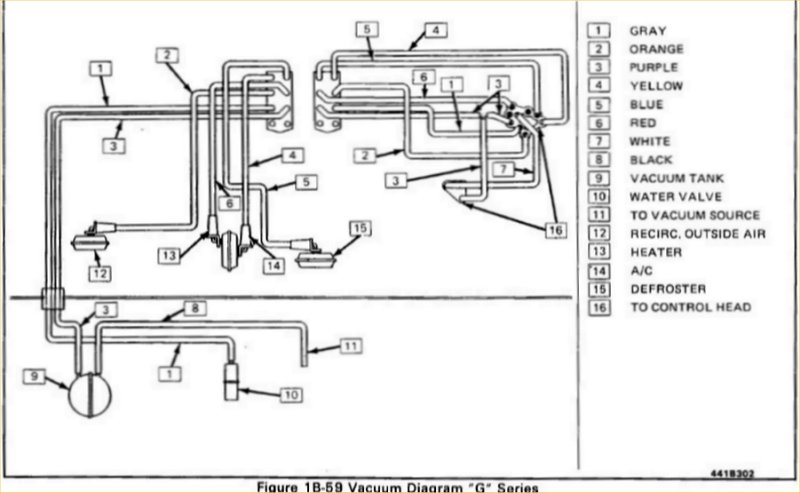

Just purchased the 3rd TR since 1987 and this ones a 14k GN thats been in storage for years and is in great shape. With the help from you guys here I have already replaced the timing chain and gears, oil pan gasket, 42 lb injectors w/ TT chip, hot wire and Walbro pump and it runs great. Doing the vent visors and headliner in the morning but getting to my next problem, the ac blows out the floor. I did the search and have already replaced the 9 and 2 port valves but that did not fix the problem. Next I pulled the glove box and checked for vac leaks but did not find any. I manually closed the door on the far passenger side but that did not make the ac come out the vents. Not sure which door changes the flow from floor to dash but I need some advise. I'm amazed with the help from this site on what I've been able to accomplice including getting the cam sensor correct but can't believe this air distribution has me stumped. Help and thanks
it's one of the vacuum lines. Check the two lines under the hood. One of them may be cracked/broken and will need to be fixed/spliced.
Danster thanks a ton, when I pulled the fuel rail to install Eric's injectors I unplugged the 2 main vac lined on the square box beside the EGR valve. Plugged it in and everything works as it should. The car ran great even though that line also supplied the EGR with vacuum. Anyway as I said before this is a great site and I have received great advice everytime I have needed it. We'll today it's raining in Alabama so it's a good day to install the headliner and vent shades in just hope there's enough space to get it out the PS side without too much trouble. Thanks again Danster
