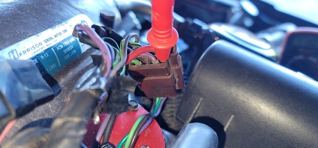

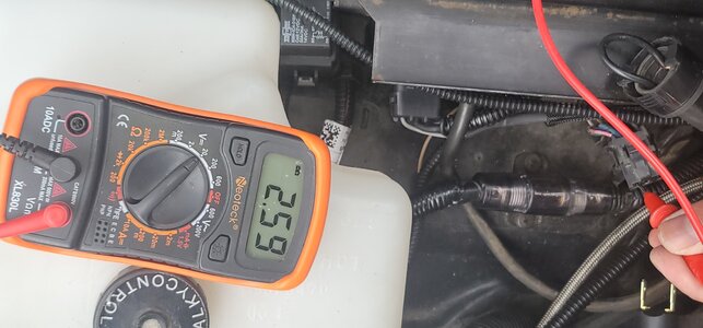

Just checked the purple wire at the brown 5 pin Harness and i get 11.17v when the controls are set on heater amd economy only at Hi and coldest.
When the controls are set to Bi Level and Auto at Hi and coldest the voltage reads 1.06v.
I also checked the pressure switch and when it is on Auto and Heat the green wire on pressure pigtail reads 11.07v.
When I switch the settings to Economy and Bilevel the green wire on pressure pigtail reads 2.72v

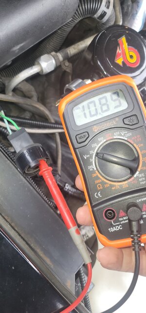

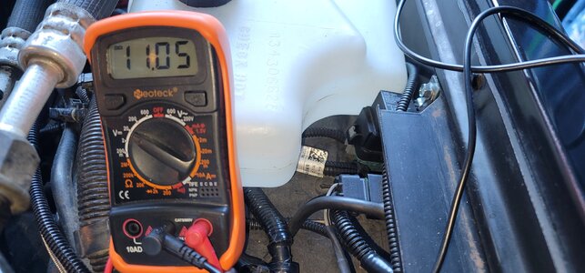

Okay so I put it on Economy Cold 65, it sends 12v to the green, jumped the switch pigtail and it only sends 2.6volts to the relay. Is the plug in that goes to the ac pressure switch bad.....should I just put new terminals and try that? See if 12volts goes to the blue wire on relay this way? Also when i run the green 12v to the one side of switch and put the meter on the other side it shows 12volts coming out of the ac pressure switch. It just doesn't get to the relay at 12volts...instead 2.6v. It should be getting to relay at 12volts correct?
