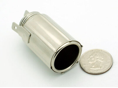

I’m trying to replace my cigarette lighter and was wondering if anyone knew how to remove it. Do I need a special tool? TIA
I recall you unsnap the radio bezel. Unscrew the heater control unit and the you get at the lighter. You probably have to pull the radio as well. Very simple
To remove the cigarette lighter from the bezel, disconnect the electrical connectors on the backside of the cigarette lighter, unscrew the outer sleeve and slide the cigarette lighter through the bezel.

Brad was correct, with the installed of my aftermarket stereo ,I do remember unplugging all electrical connection and screwing out the inter
sleeve.
