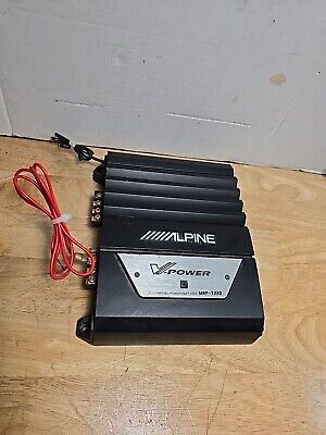

When I upgraded the fronts I used 8 ohm home stereo tweeters. Small speaks don’t produce bass anyway.
Something like this would be plenty.
You would need the speaker level input wire connector.
