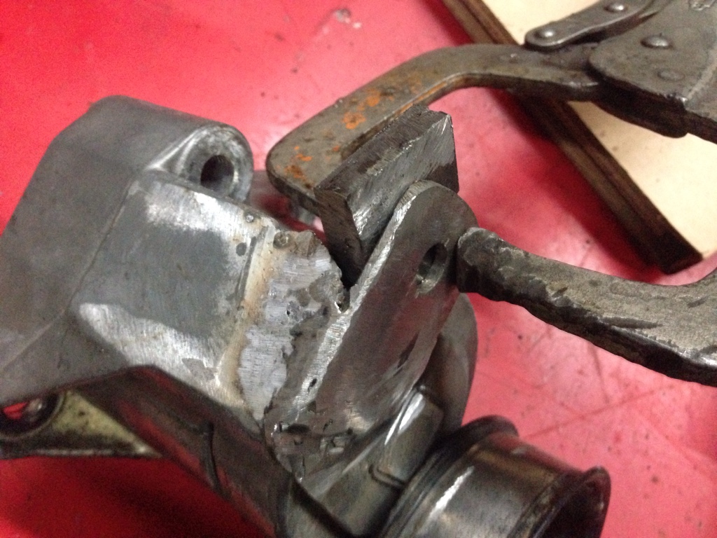

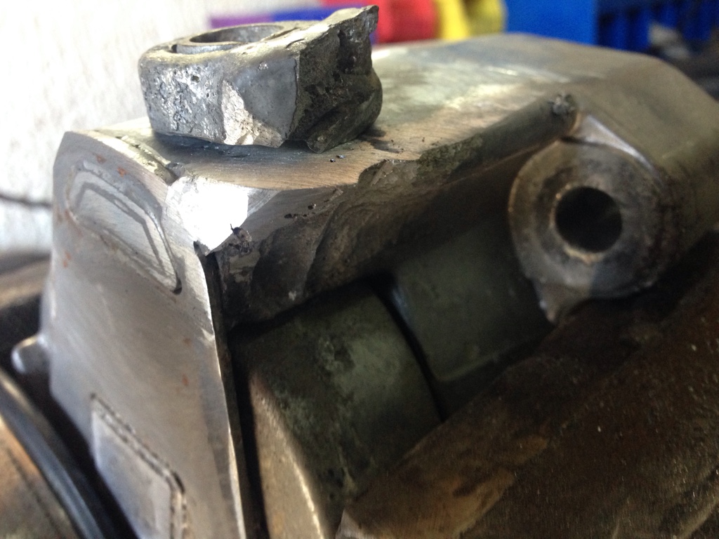

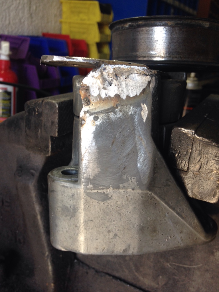

Heres my initial belt tensioner!

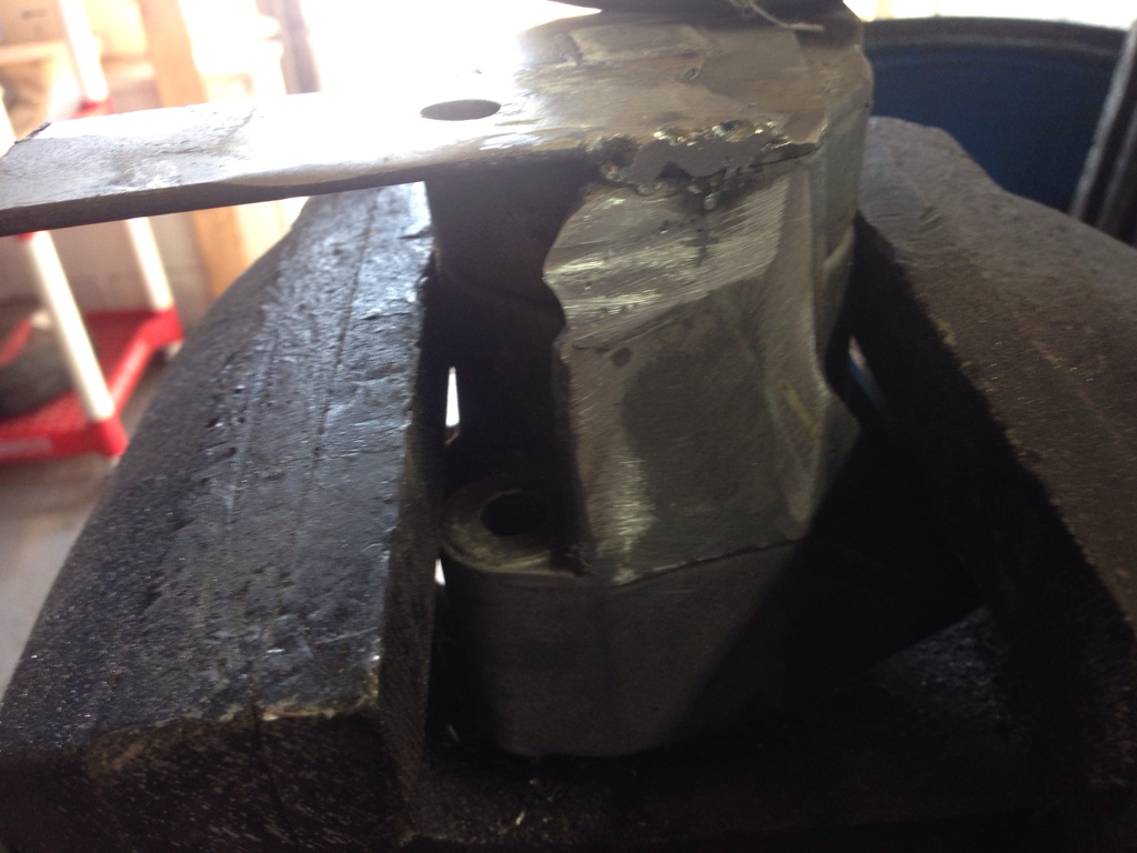

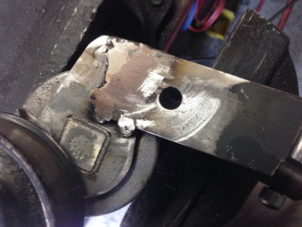

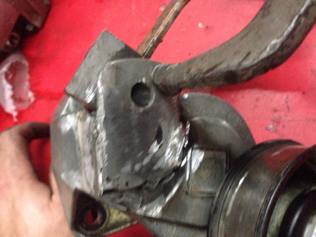

Next i welded a metal plate 1/4 inch thick to the front steel plate (my welding skills are very basic so sorry for the quality!)

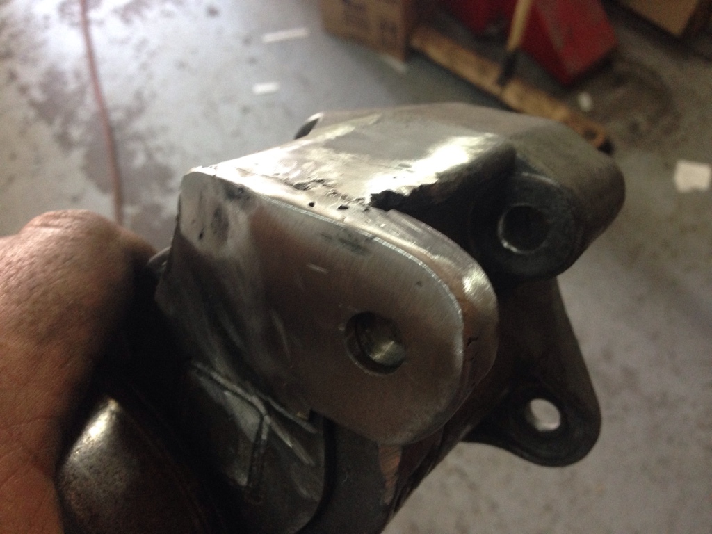

Then i trimed down the metal piece to about the right size!

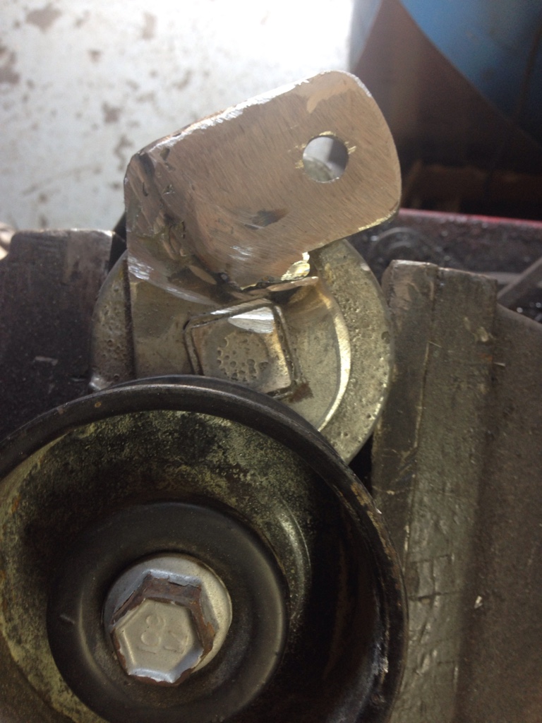

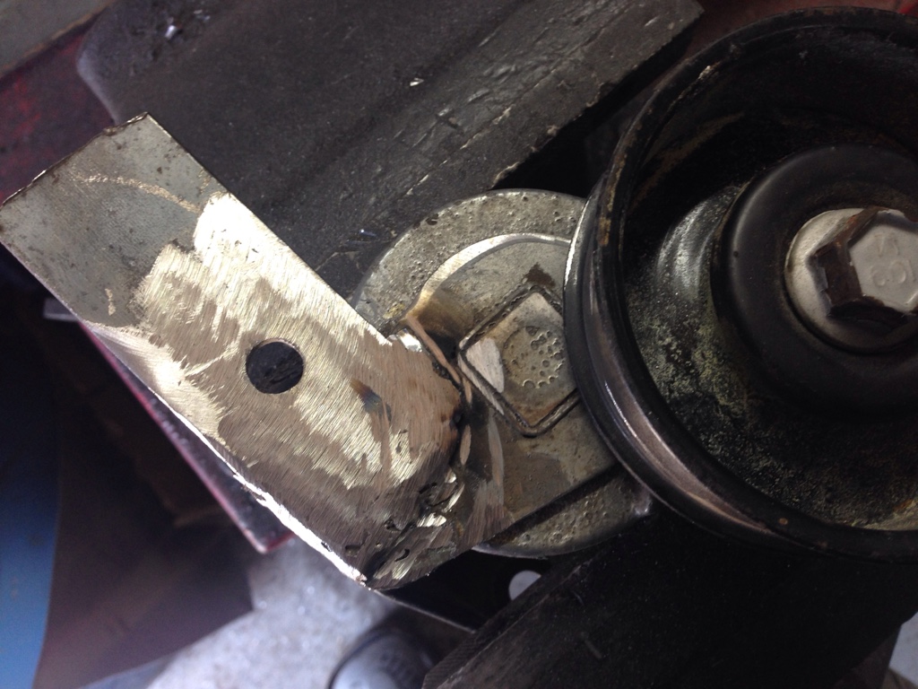

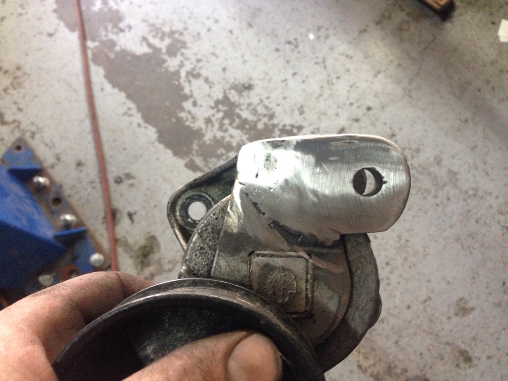

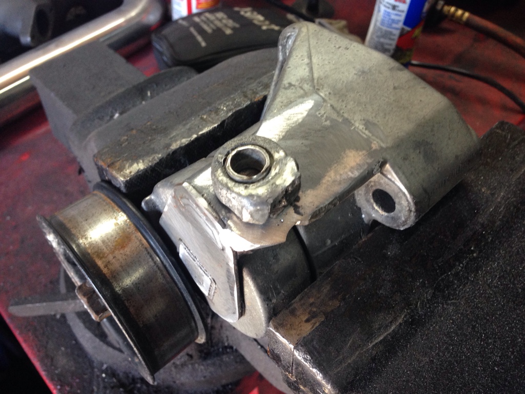

Then welded 3 piece of 1/8 inch metal toghether fir the spacer between the alternator and front ear( should have done 4 would a fit like a glove)

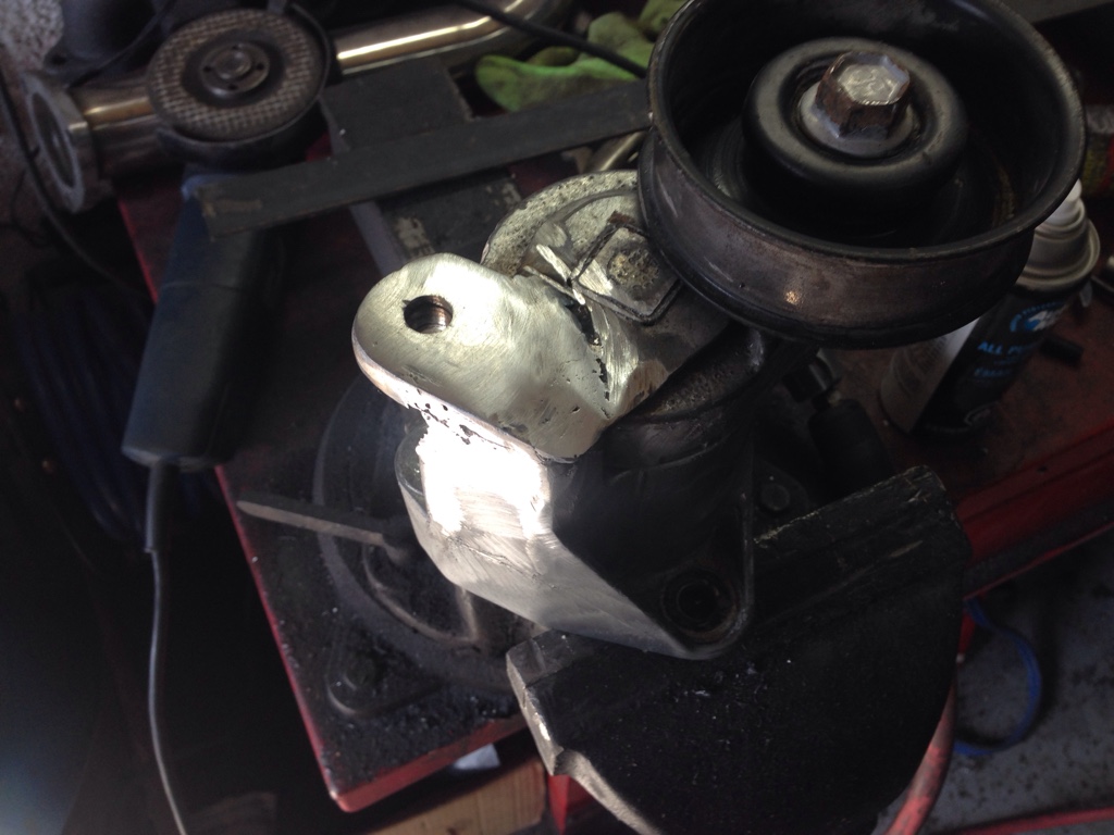

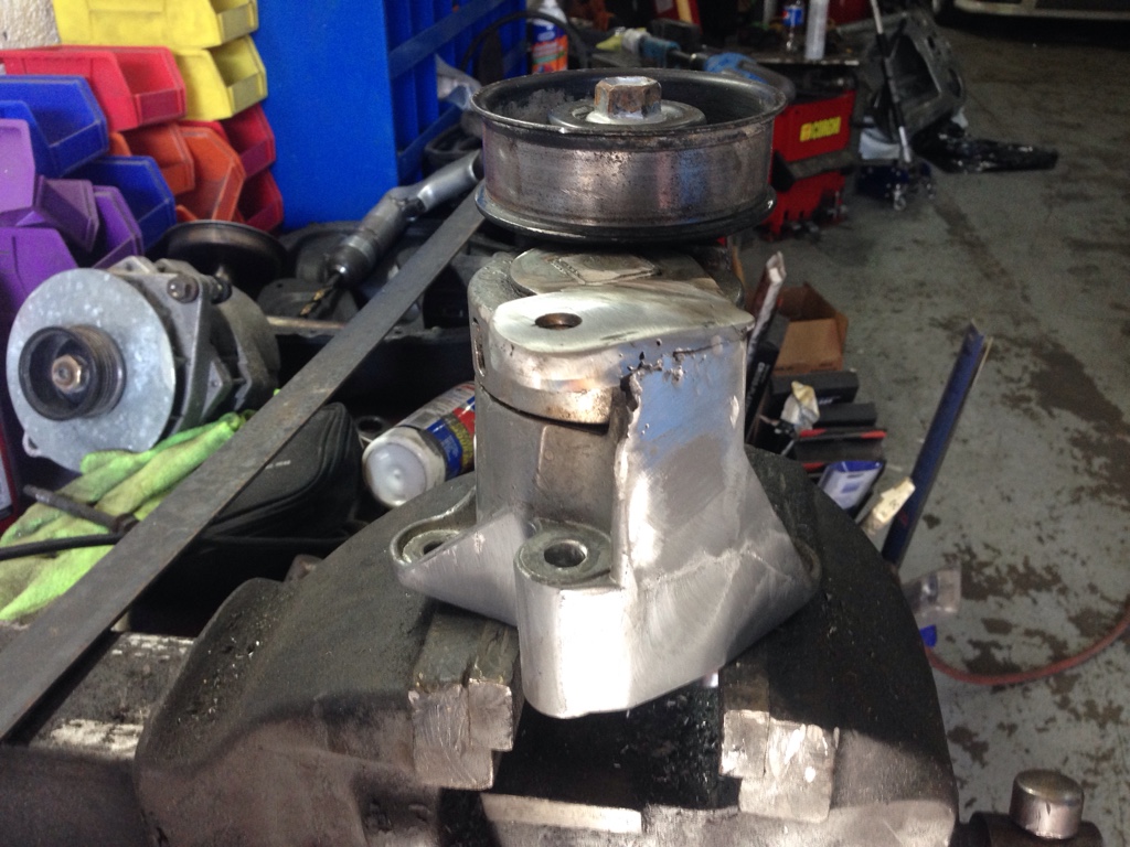

Then welded to the firs piece and trimed down and grindrd the welds!

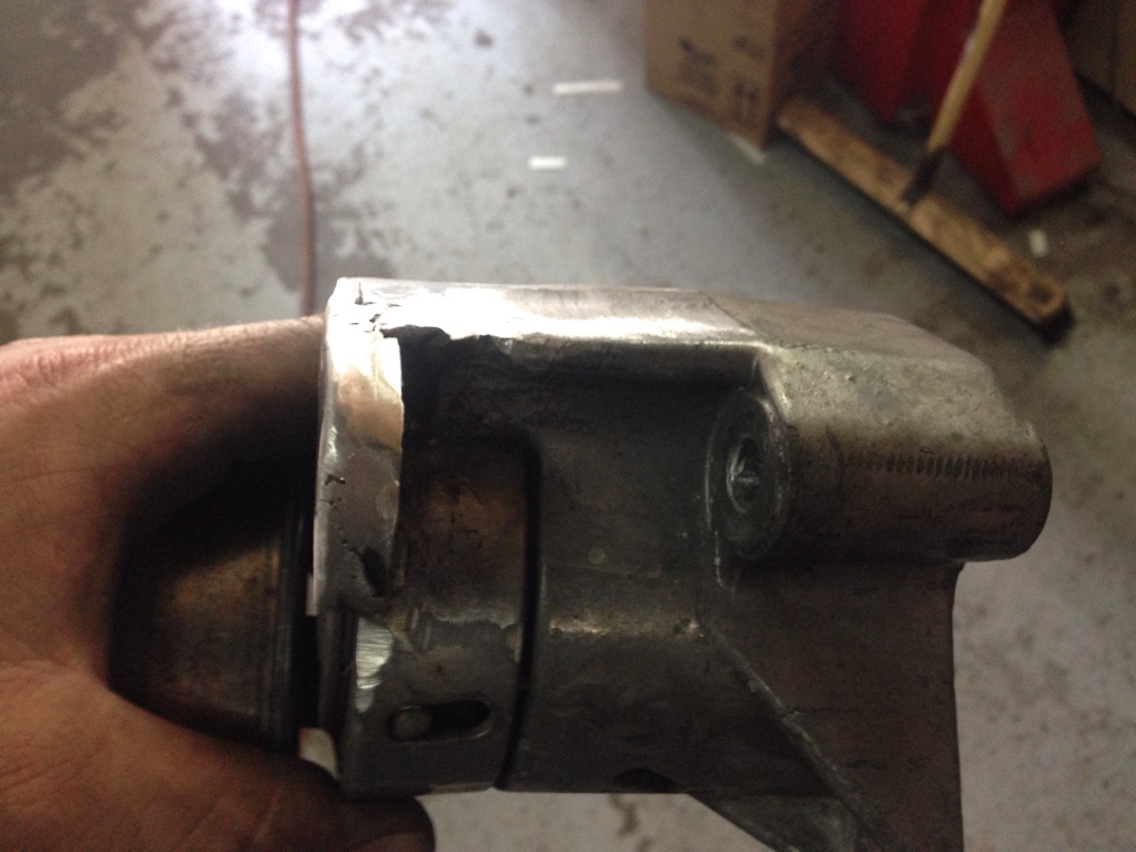

Then i drilled a hole for the alternator bolt and did some more grinding and polishing

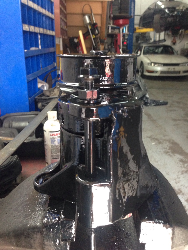

Heres finished product before paint!

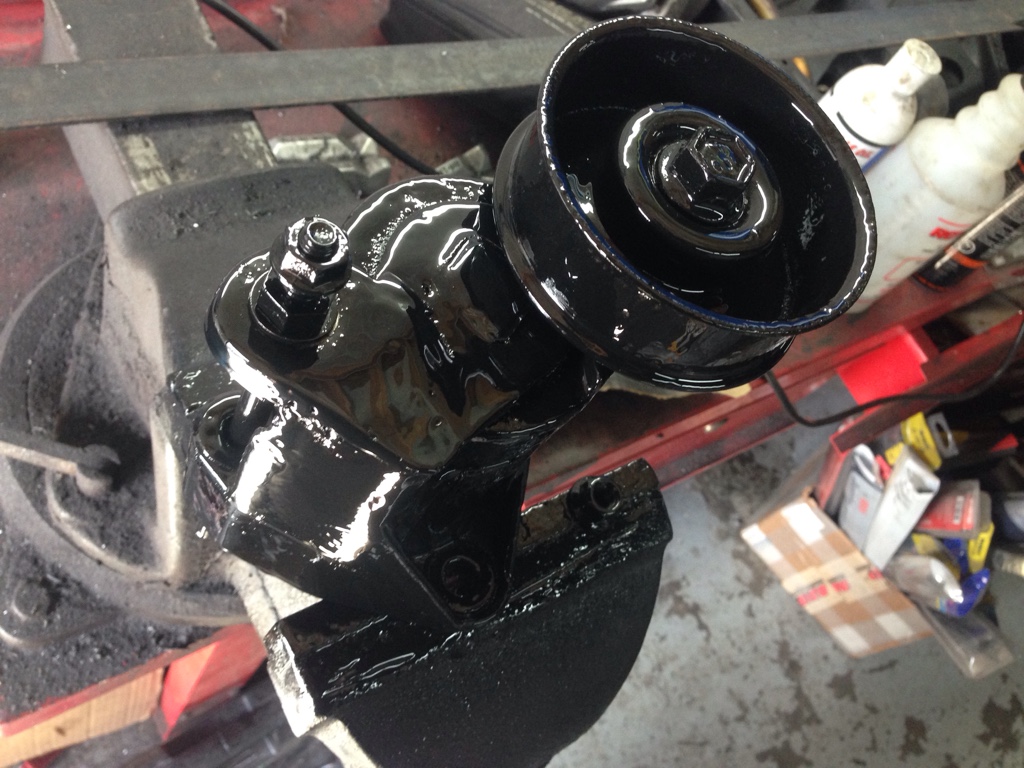

And all painted!
So i know its not perfect i know its maybe a bit crooked i know the welds are maybe crapy but like i said i tried something and it looks very solid so for a biginer i find it not to bad

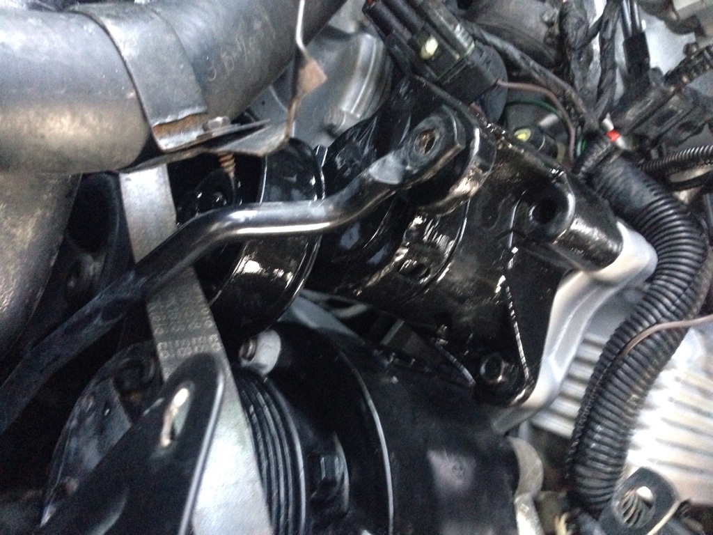

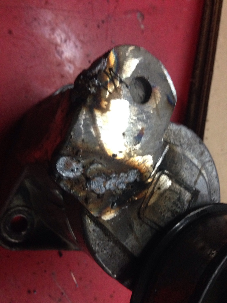

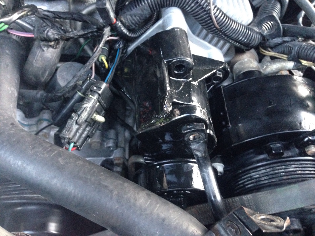

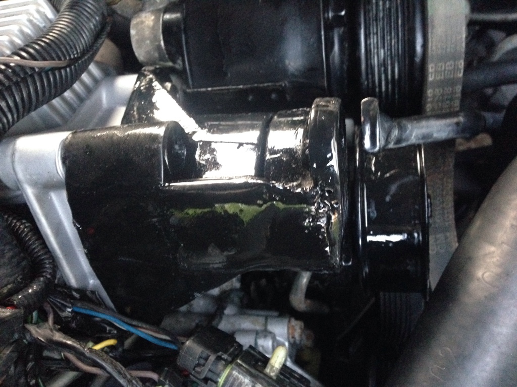

Here are some pics of it instaled on the car!!
Well guys i have a hole summer on this fix and still holding strong!
