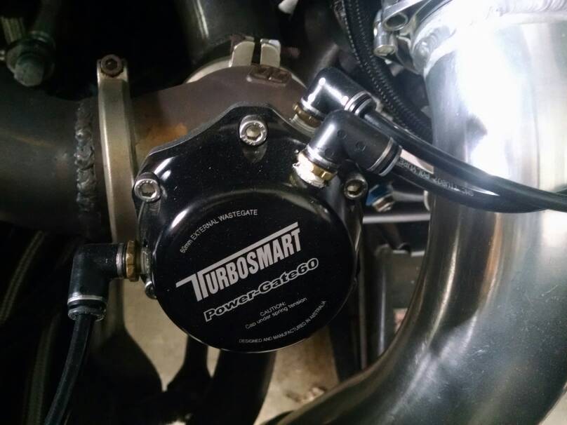

Here is how I have mine . Really not hard to do . Remove the top of the wastegate and drill and tap a 1/8 hole .
Where do you drill it? I was looking for more step by step than "yes you need to drill another hole"
I'm sorry I didn't realize you needed a step by step to add another port. Remove the top of the gate and then get a R sized drill bit and drill the hole where u want it . Then get your 1/8" 27 npt tap and thread the hole you just made . Here is a tap chart to help

Thanks. I don't have a problem tapping the wastegate, but just wanted to make sure it was in the right spot. So when you say "top" do you mean the current orientation or the one that is facing towards the front of the car?
As long as it's on the top side of the wastegate you are okay . Put it anywhere you want that makes it easiest for you to plum . I use all quick connect fittings to make life easier . I have my CO2 tank mounted in the trunk then a 1/4" tubing ran to the front . Agian the quick connect fittings make life a lot easier when pluming it .

Thanks bud . Any time I had any questions I shot randy a text . Since he makes boost leash he would be the best to answer any questions you had . Thanks agian Tyler for the kind words
On my setup, I did not run two lines to the wastegate itself, instead I just used a quick connect "T" in the combined CO2 pressure line to the wastegate (after the solenoids). New instructions from Randy may say not to do this though, I have a slightly older setup on the car. I don't really see a strong reason to have the sensor right on the wastegate anyway, the pressures should be very near uniform everywhere in that circuit.
