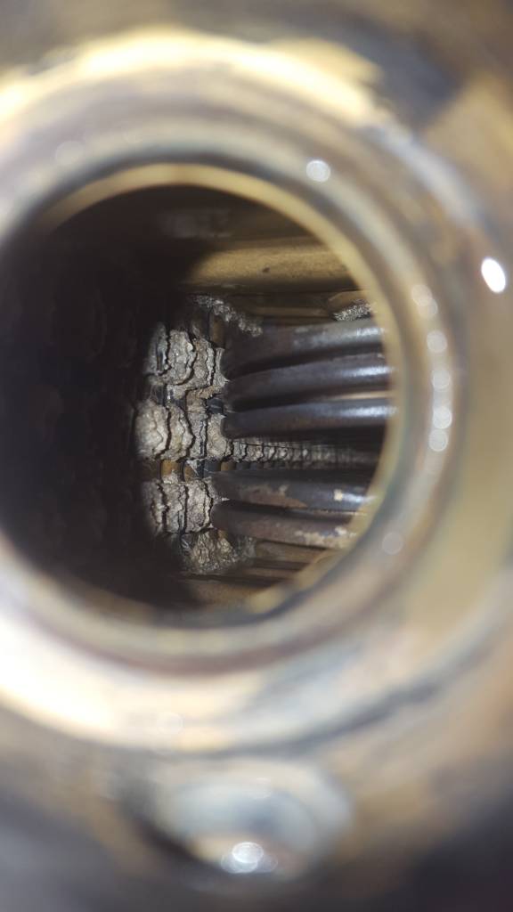

So I have some build up on the fins in the Rad , Has anyone used CLR to flush it out ? I know it needs a cleaning just trying this before I have to remove it and take it to a rad shop . Thanks for the help in advance Keith
I would think CLR might degrade the hoses and/or gaskets if you run it through the cooling system.
I don't think soaking the radiator in CLR would do any good at all.
Once again, I could be wrong. Others will chime in soon, I'm sure.
CLR does work. I use a whole bottle and pour it in let it run for an hour or so or drive it. I don't use it in antifreeze. It will eat the buildup out of the radiator. Afterwards I flush the system real good. Pretty sure it isn't good for the hoses if mixed too strong. You can pull the rad and seal the inlet/outlet and mix clr with a gal of water and pour it in and let it soak.
I'm gonna give it a try tomorrow , I'm nit gonna mix it to strong . I will drain all the anti freeze and mix it with water and try that .
Think you are just wasting your time & potentially asking for more trouble.
EDIT: You may end up breaking up enough sediment to plug your heater core.
Do it right the first time. Either have the radiator tanks removed & replace the core with a HD core, or purchase a quality replacement radiator from Arizona GN, or ALRADCO.
Does your radiator look this bad? In traffic with A/C I saw temps in the 220s.
CLR is basically a light cocktail of various acids. Acids eat metals like aluminum, copper and iron. You may do just as well with white vinegar. Or brick cleaning acid (muriatic acid).
I wouldn't worry to much about the radiator. Because it's probably junk anyway. But running acid through everything else? If you want to try to save the radiator that bad, maybe remove it and fill it up with the strongest stuff you want (like muriatic acid). Let it sit for as long as you like. Then rinse the crap out of it. It wouldn't hurt to put some Alkaseltzer tablets in it afterwards with a new batch of water for another hour or 2 before a final rinse and then install.
But I wouldn't trust that stuff (or anything) going through my engine.
Yes guys I'm really trying the low cost fix here and yall are all right that it may cost me more in the end but I wont know till I try . I will report back
Baking soda instead of alka seltzer. You won't believe how much crap is in cooling system. Friend did his rad off the car a while back and the water was almost milky looking after it soaking a couple of hours. I would never ever leave it sitting in the car or not back flush the whole system for several minutes.

If the crud is visible at the top, there's a bunch more, closer to the bottom.
