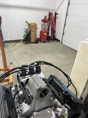

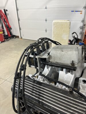

Hear is what I did I used the TR6 truck coil wires in stock location
