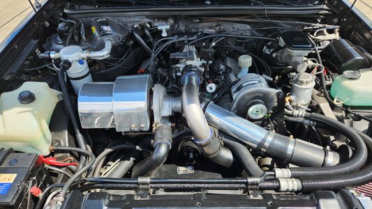

Hello
I have a complete 1987 Buick Grand National in Japan. There are no experts in Japan, so I'm not sure what the correct condition is. I'd appreciate any advice.
The idle speed of my GN periodically fluctuates between 650 rpm, 675 rpm, and 625 rpm. Please keep this within the range. Is there a problem?
I tried cleaning the throttle body and IAC valve, but there was no change.
It runs perfectly smooth while driving.
The engine starts easily when cold, but when it warms up, it won't start unless I turn the starter motor for a few seconds. Does this have anything to do with it?
Hello
Do you have a stock or aftermarket chip? Do you know what your TPS settings are?
What Maf are you using?.
Any scanmaster numbers?
I am also using the original MAF.
I have attached a photo
625-675 not horrible but it should be smother in Park
TPS Good ,OE chip with EGR probably not the best combo. I see fuel pressure around 28 vacuum line on at idle probably OK, but it not adjustable on your car.

Thank you. It's true that the problem only occurs when idling in drive range.
I'm relieved that it's not a malfunction.

Is there any connection between the fact that the engine is difficult to start unless you turn the starter motor for a few seconds when it's warm and idling?
TPS = .44 at idle is good.
The IAC counts (position) should ideally be 15-20 in park when idling fully warmed up. If this is too far off (0 or 50 for example) it indicates that the closed throttle position is not optimal and that could affect starting. This is assuming there’s not a vacuum leak that’s causing the IAC position to be too low when idling.
Thank you. I didn't know the IAC count was related to engine starting.
With AC off, it's below 25, but with AC on, it exceeds 30. In Japan's climate, we use AC most of the year, so should I adjust it to below 25 with AC on?
That is the ECM looking for crank and cam signals to fire correctly. Nothing to worry about on a stock Buick.
Thank you for the helpful information. I guess this is normal with a standard ECM. I was worried that something was wrong because the engine starts right away when it's cold, but I'm relieved now.
TPS=.44 is good (max) but good .38-.44 no need to adjust
IAC count is different on every car
EGR is somewhat problematic on older GM cars. If Japan permits you changing to a TT chip and 42's it will do a EGR delete and would move you in a direction of a more drivable car.
You must have a ScanMaster or scanner on the car to be looking at TPS and IAC this is a much needed tool. Thank you for having that tool making helping you easier for use.
Just remember every time you return the Key to the OFF position and back to the start position the ECU will turn the Injectors on and can flood the car with fuel and make hot start more difficult.
Thank you for your advice. It seems that the reason it's hard to start is not because there is not enough fuel when restarting, but because there is too much. I learned something new.
