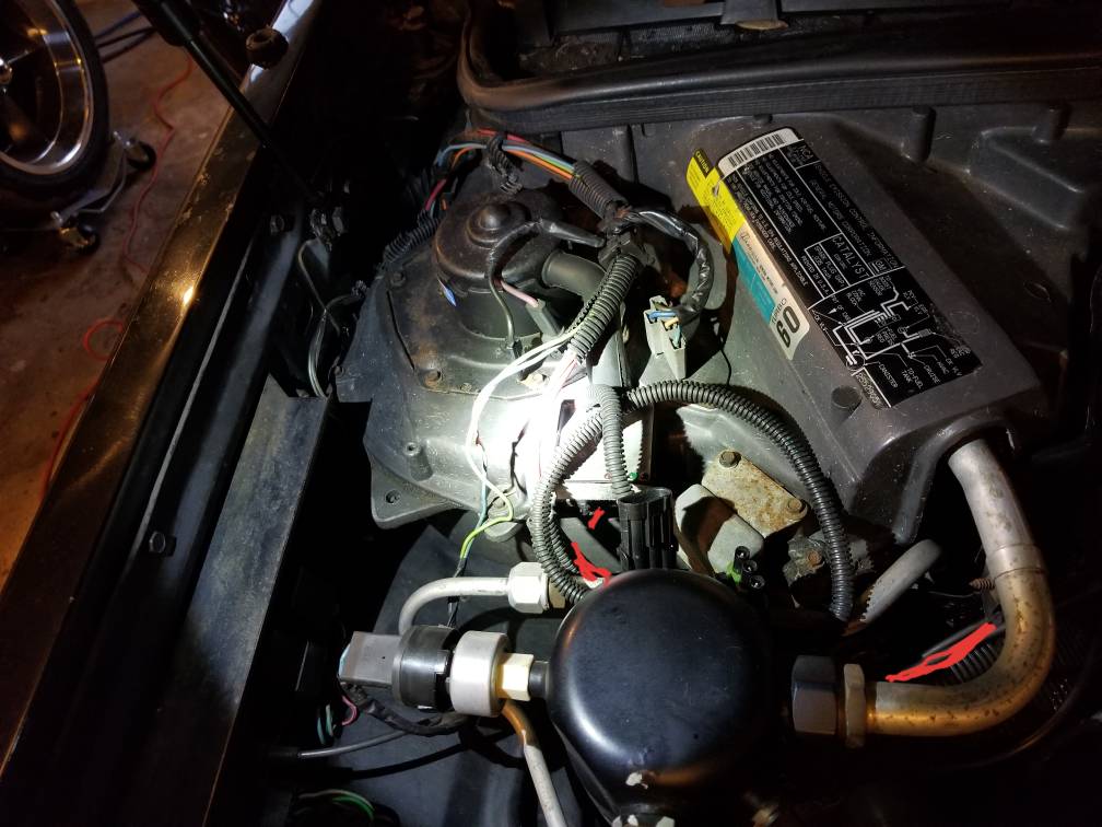

Looks like its working now, but no high fan. Isn't that relay located separately?

captndave737
Feb 14, 2006
921
130
43
66
Raleigh, NC
By dash air I assume you're talking about defrost? That vacuum line runs to the heater/AC control head. The controls do 2 things, move the cold/hot mixing door with a cable and operate vacuum motors. This is the part that distributes the vacuum and is on the back of the control head.https://gbodyparts.com/product_info.php?cPath=46_21_174&products_id=2990&osCsid=52e774b95598e228dea6db7ebc30ed4f.
You may have one door closing but another not opening.
No high fan can be lots of things other than the relay which is the little silver one between the blower motor and the AC dryer. Here's a link to a thread on the topic.https://turbobuick.com/threads/blower-motor-inop-on-high-speed.461228/#post-3845715

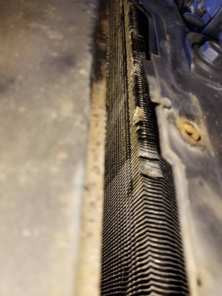

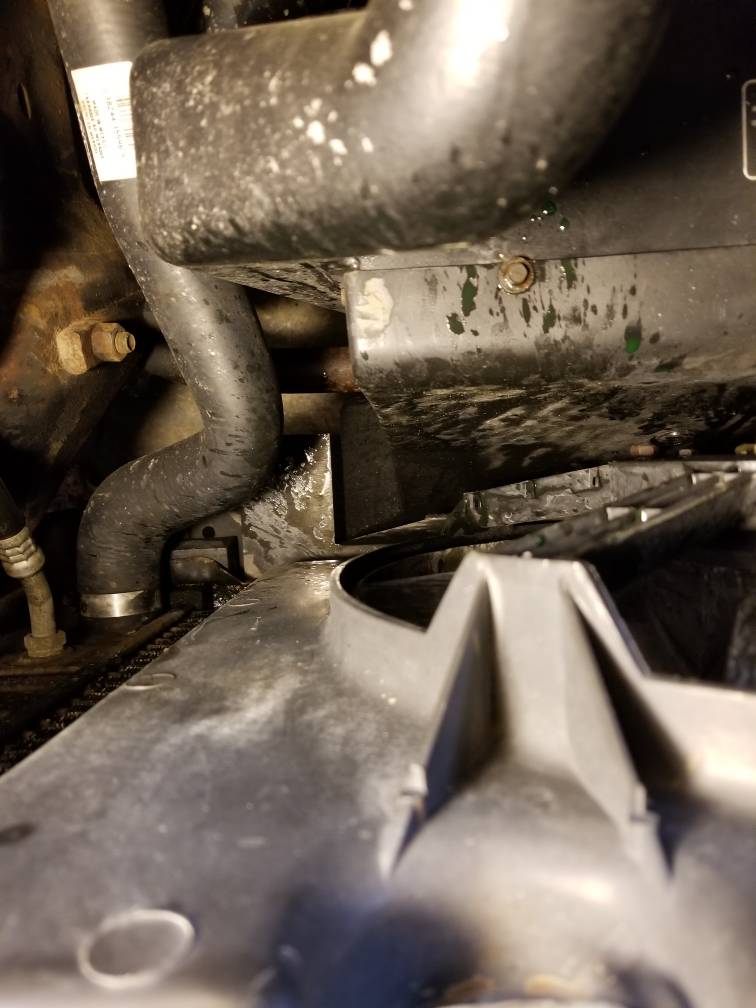

I replaced the valve as it was sticking a little even under vacuum. I now am noticing a radiator leak in between the find somewhere.
Would this possibly be leading to an air bubble or something as I'm not feeling hot water on the tube going to the heater core.
Valve is definitely open.
Sent from my SM-N950U using Tapatalk
captndave737
Feb 14, 2006
921
130
43
66
Raleigh, NC
Well you have to get the air out of the system and the thermostat has to be open before you'll feel hot water going through the hose.
Where is the leak?

mattcsn
Nov 2, 2018
62
0
6
32
Where is the leak?
Can't pinpoint it exactly, but the fins on the radiator are wet and smoking. When driving it throws the fluid around so can't find where it's coming from.
I think I'm planning on flushing the system and replacing the radiator.

captndave737
Feb 14, 2006
921
130
43
66
Raleigh, NC
If it's stock and hasn't been maintained it could be corroded through. A radiator shop can re core it. Personally I'd go with an aluminum radiator though.
