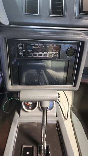

    Okay, it's finally mostly complete... As mentioned, it's a VERY tight fit. Wiring harnesses can be grabbed and pulled back if you drop the glove box and reach in behind. Otherwise, the mess of wires will make the radio not slide in all the way.
    I forgot to hook to hook up the power antenna and plug it into the back of the radio so it'll come back out today......but otherwise, just final tuning to make it sound perfect.
    I had to cut the bottom of the factor bezel to make the radio fix and have the face plate look somewhat good......overall, I'm happy with the way it fits...... not 100% but keep in mind that these cars wer enever meant to have a double din radio in it...... but Havi works which is a nice feature...... like most upgrades and things, JUST BECAUSE..........
