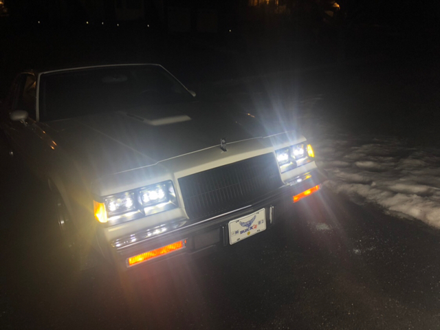

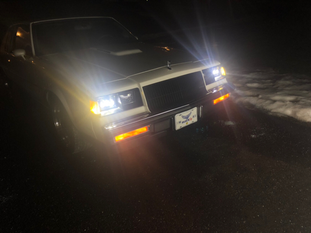

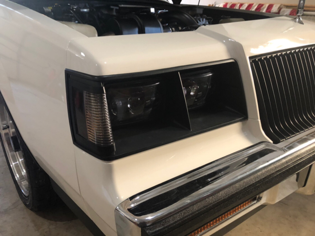

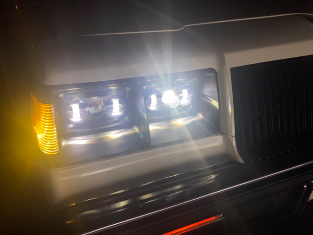

Those look different, do you get flashed from on coming traffic?
Did you just take that picture?
This is what mine has looked like for a few months now, won't be seeing the light of day till probably May.
ScottHeidinger
May 2, 2015
609
90
28
50
northeast Florida

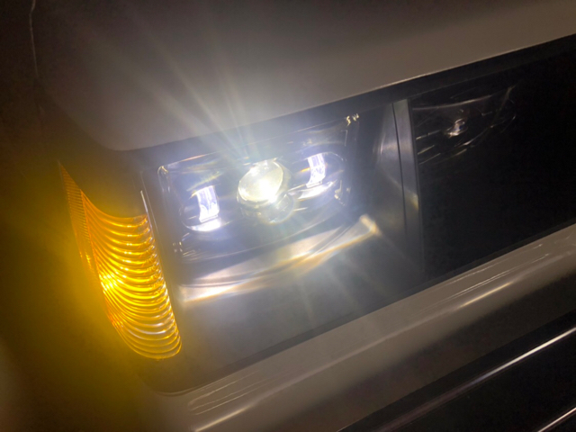

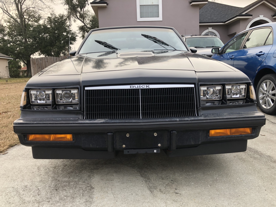

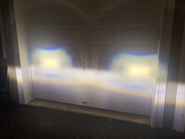

I don’t get flashed. The lights have a sharp drop off pattern and probably put less light in the on coming traffics field of view than the stock headlights. They are DOT approved and the only downside I’ve found is the price. They are awesome. I used to hate to drive the GN after dark because the headlights didn’t work very well. I didn’t change anything but the headlights and now I love to drive the car at night. I can see great with the low beams and the high beams allow me to avoid overdriving the headlights at any speed. They aren’t cheap but if you drive after dark it makes things much easier to see. I’m in Florida and this car is driven daily all year. It’s not a garage queen. It’s a low mileage daily driver.

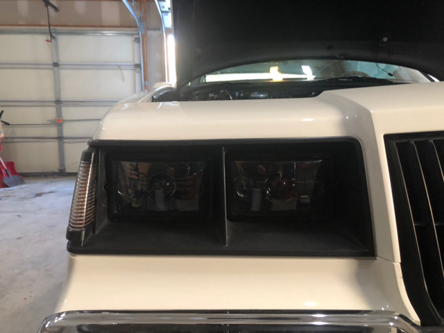

In case you prefer stock looking headlights, I certainly do, I would recommend these. They're very bright LEDs, do the job and they're a great value:
https://www.ebay.com/itm/H4651-H4652-H4666-H4656-Head-Light-Glass-Housing-Lamp-Chrome-4x6-LED-Kit-B/322177900131?ssPageName=STRK:MEBIDX:IT&_trksid=p2060353.m1438.l2649
In this photo I just have them in the outer positions, the stock hi beams still original. Since this picture was taken I've put another set into the hi-beam position.
Those look good, very stock appearing. I'll check them out.
