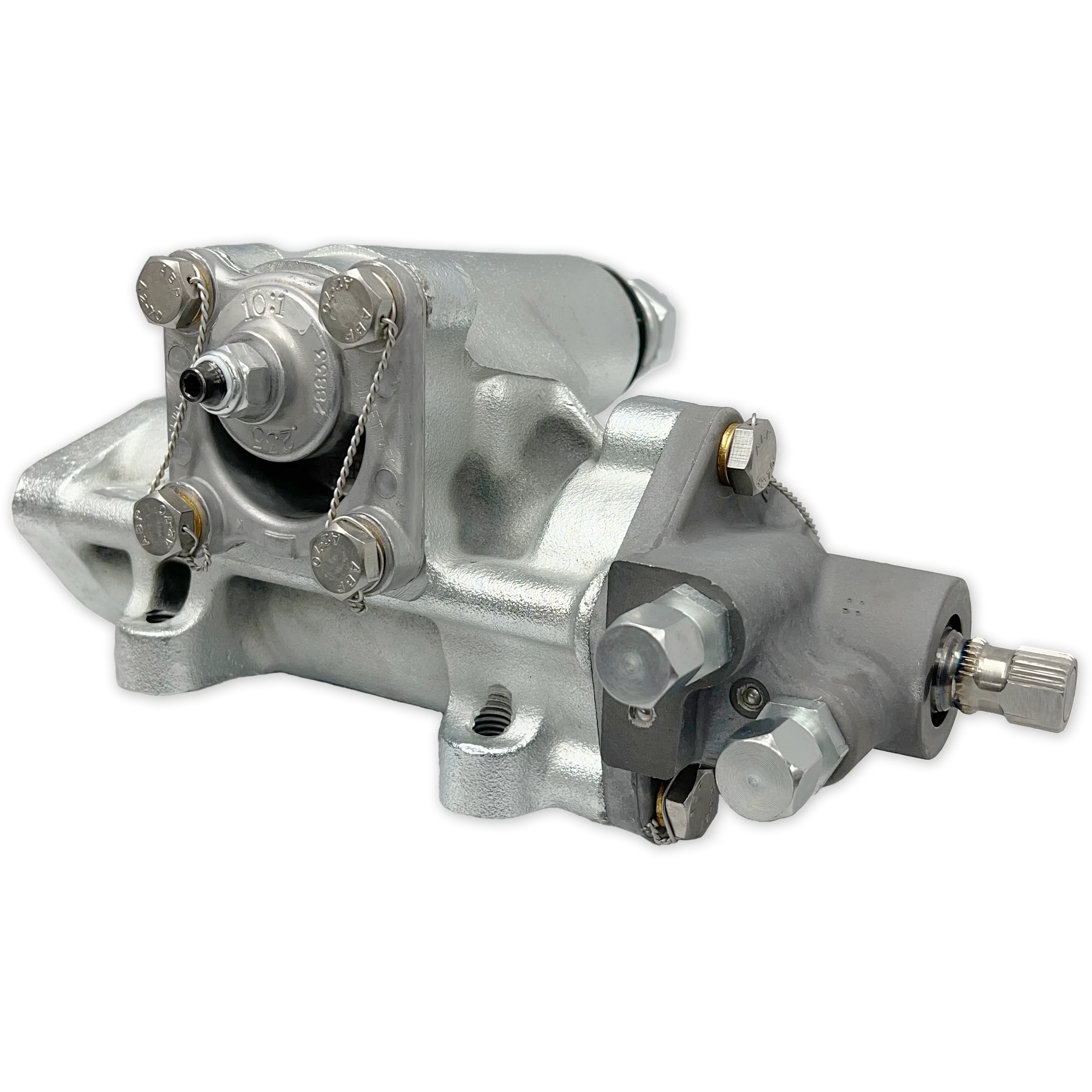

I’m not sure if it’s worth it for weight loss only, but Sweet Manufacturing makes a 600 series steering box that’s 7 lbs less than the stock steering box.
I wanted an all new faster ratio steering box and got their 10:1 steering box with the .200” input valve.
Their 600 series box has 4 mounting ears whereas ours only has 3.
I cut the extra ear off and smoothed the rough casting before painting semi-gloss black. It weighed 21.9 lbs when done.
If you really want to lose 7 lbs from your car and $1800 (stock 12.7:1 ratio) from your wallet then this may be for you.
Talk to Josh or Mark for options. You can probably get the easier steering .185” or .200” input valves for the 12.7:1 box as well.
As received.
Extra ear cut off.
Smoothed
Painted.
