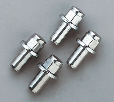

Glenn,
You dont need the longer studs to run draglites. I ran Pro Stars all last year with the stock studs and the long shank lugs seen here. If you put the 3" studs on your car, you will not be able to use your factory lug nuts when you put your stock rims back on. The best way to go is to get this long shanked lugs from Summitt or Im sure Winners Circle has em too.
I got my long lug nuts at pep boys for my draglites. they are the 12mm ones just so you know, and they come in packs of 4. About 50 bucks for 6 packs which covers all four wheels.
Nick
ARP studs from Summit, 2.5" long, don't have to pull axles. Using McGard Drag racing open ended lugs, the lugs themselves are also about 2.5" long, the stud doesn't protude thru the lug, it's about 3/8" too short, but the tech says that is just fine.
