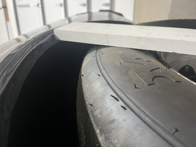

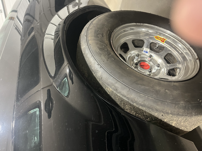

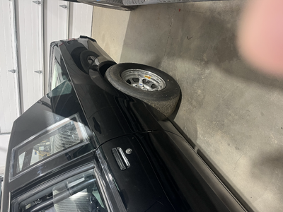

I run 28X9 PRO BRACKET 4 in backspace no finder mods OE replacement MOOG spring (not cargo spring) never rubbed 18 lb air
I think ill have to roll finder to run ET street PRO

8" wheel 4" BS will fit most every even thing even MT ET street R , but the 275 ET street Pro or Hoosier DR probably need finder rolled
10" wheel and 4.5 will be new every thing under the back
Exactly what I was looking for, thanks👊. I'm running the same size rim and tire as you. I have a few fiends running strong on Pro Brackets and they love'em.
I plan on setting up the car pretty low, nowhere near as low as a low rider but drag style low without sacrificing dead stop launches. So, it looks like the inner fender lips will have to be rolled either way.
