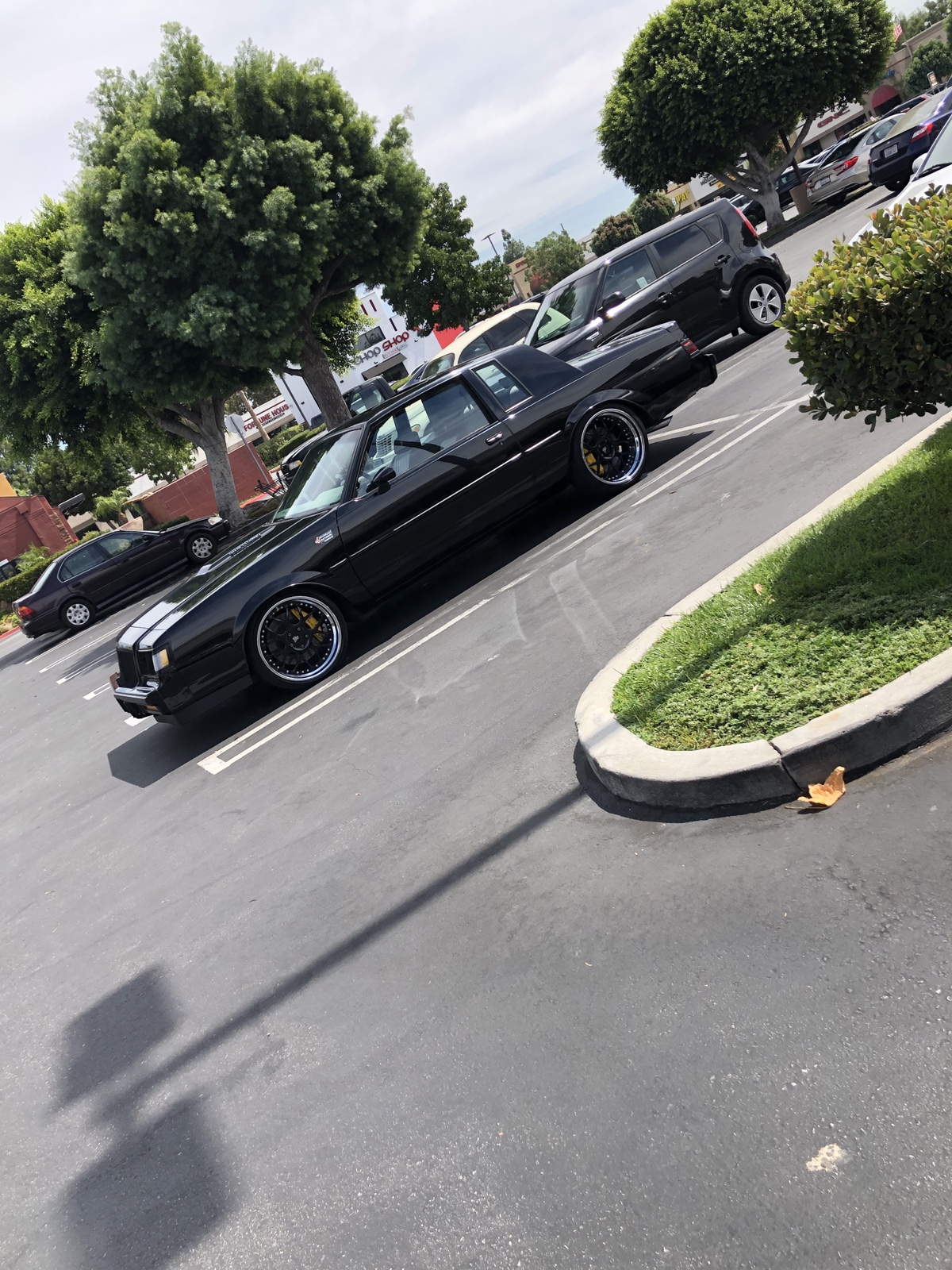

I currently have the radiator core to fender braces ( kirbans)
Umi Performance 3 point brace and rear strut bar.
Poly body mounts
Umi A Arms, tall Ball joints, bumpsteer kit and rear 1” sway, new bushings etc.
Metco upper and lower arms
Front and rear coilovers.
Car sits at this stance as of today.
