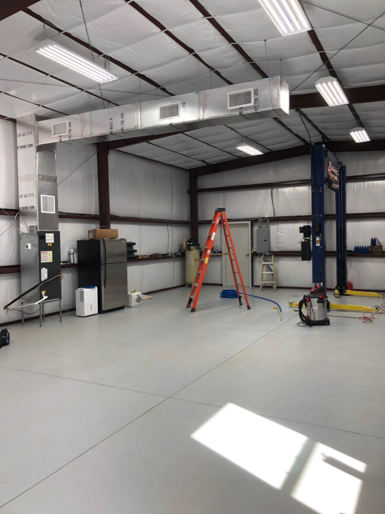

I’m just finishing the new shop so I’m hoping that makes it a lot easier than the jack stands I’ve been using.
I picked up UMI users and lowers for a great price with sway bars and HR parts rears. Wilwood front brakes. I also took advantage of a Black Friday deal on Ridetechs street setup.
Should get interesting but I put a nice beer fridge in the shop and stocked it the other day lol
Wow, nice setup! One day.....one day.
