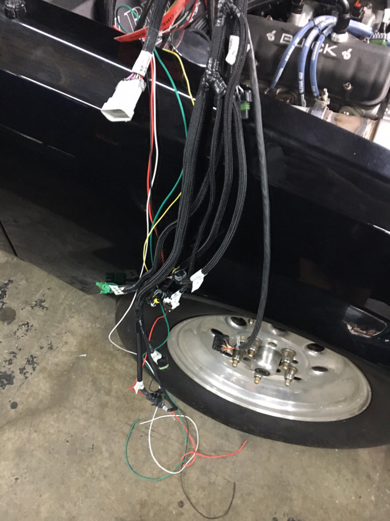

MPFI harness.

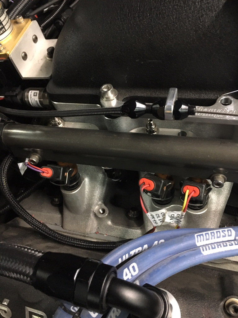

I'll remove the knock sensor and IAC plugs. Looks like everything else is plug and play. The length is working out good too.
Harness has built in oil pressure and fuel pressure sensor plugs as well.
The IAT is mounted in front of the manifold and will require an extension with this harness. If it was in rear it would fit fine.

An off the shelf Holley harness worked with this setup, and that kept the price low. Cruz offers custom harness tailored to what is on the car and they get more expensive depending on options.
