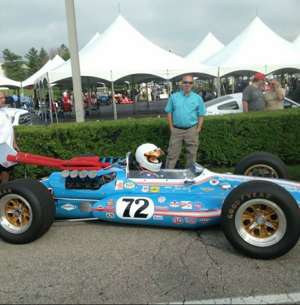

I have a March 86a Indy Lights car with a Buick stage 2 engine. My original ecu is not working and I am going to purchase an aftermarket ecu and harness. My car has all the standard GM plugs to all the engine accessories so a harness should be straight forward.

Badass bro . I would think a fast setup or something similar should work for you as far as the harness goes I think you will have to do a custom type because of your not a regular type of car .

nice ride!
