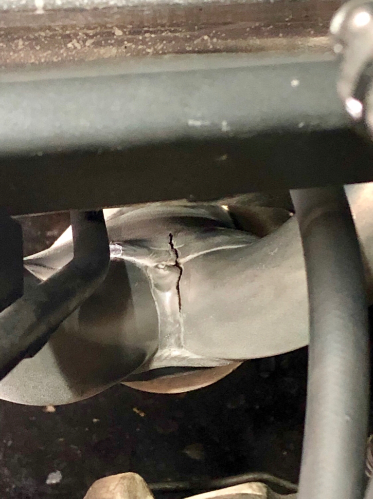

Getting ready to do a build this winter and decided to check the compression and in the middle found 2 nice cracks in the header and cross over pipe. Damn it! Time to go stainless I guess.

Just weld the header and add a triangular gusset to keep it from happining again. All TRs do it.

That’s the plan, sir.
