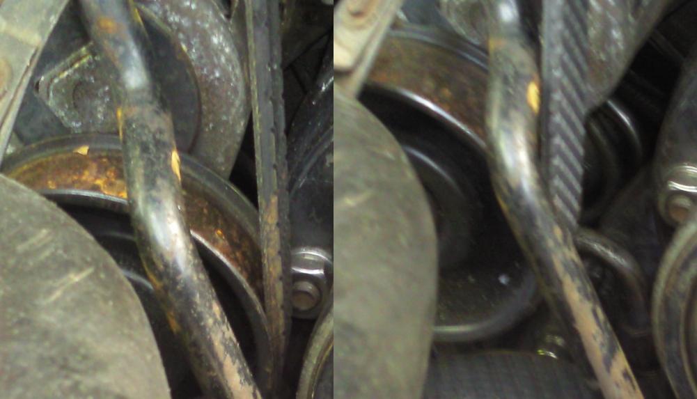

My car didn't clunk or rattle but here's the difference between an old 'correct' belt, and my new one.
It's pretty much as close to the intercooler bracket as you can get without hitting it. My tentsioner is nice and loaded and nowhere near out of range.
