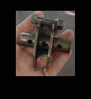

You can always make one if you have the time an skill.
Old rocker ,rocker shaft, welder an a bolt works for me

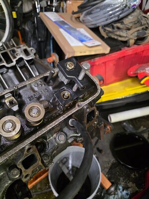

You can buy a rocker from rock auto for 5 bucks, piece of pipe from the hardware store and use a line wrench to compress. That's what I did and it worked fine.
Bluegrass performance makes a pretty decent one, but upgrade the pedestal bolt to a grade 8 lol
