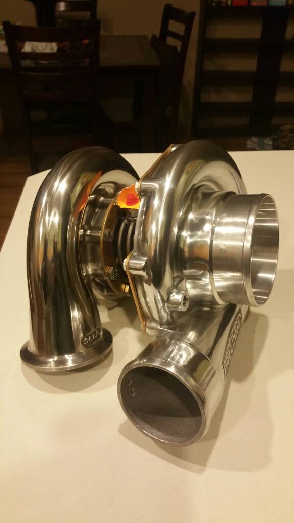

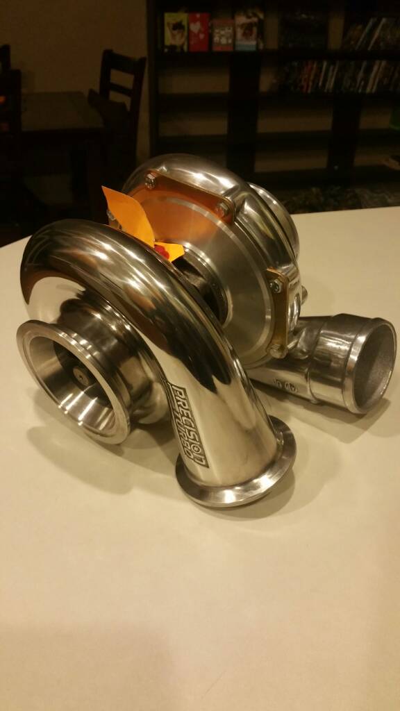

Well got my turbo today, It is a good looking turbo, Talking about my suspension, It was setup for a car with a stock block small turbo car that run 11.60-11.80's, Well when we built the engine and transmission and more things than I can think of and the car runs low 10's it just needs a few things changed, Like I said 22 pounds and it run constant 10.40's, The chip was burned for 24-26 pounds but as soon as the boost comes on it lifts the front and as soon as it sets down it unloads the rear and spins the slicks, I know a couple things that need changed, As for the 66 I don't know how it cost to have new bearings put in
Double-L you are going to love the 6870 it makes amazing power, i have it and my tires are crying for help as it rips them apart. The tuning with your combo will make a big difference, all the best.
