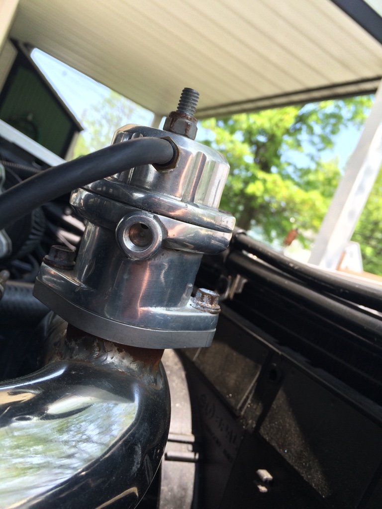

Anyone running a blow off valve, step on in...
Yea the recirculating aspect I don't get either. Like Evil said, with the amount of intake piping I have I would think that air under 25psi that suddenly has no place to go (when the throttle is closed) and is vented back into the intake pipe would just make its way back out of the air filter and potentially dump a bunch of pressurized air behind the MAF.
Bob thank you for that info. The main reason I hooked mine up (like I said, it was included in a package I purchased) was for the "drop throttle flutter" to hopefully prolong the life of my turbo.
Again, my issue now is that I can't seem to get all the air to vent out. I get an initial expelling when I close the throttle but then still get compressor flutter in conjunction with (what sounds like) BOV flutter
And for the life of me I can't find anywhere that states the Turbonetics Raptor "Godzilla" BOV has different springs.
Also as far as I can see there is only one vacuum port.
with mine it takes away most of the drop throttle surge. I stull get some flutter after the pssht...
this should be the second port.
Not to hijack this thread, but what is the general consensus on eliminating part throttle surge then? Bigger turbo? electronic boost control?

I just realized that there is a hole in that second port. Thought it was just blocked off.
That being said, is there an issue that I have that open right now? And you said if I add a boost source to that it may help. I obviously need to get a fitting for it. Where can I tap that source from?

Ok Fast4Ward, that is what I need to see. Couple questions:
First, mine is mounted close to the turbo and not recirculating (not going to make it recirculating). What vacuum source did you use?
Second: the bottom valve and vacuum line. What is it and where does it go. Mine is open right now (didn't come with the second valve)
Finally: how much did you adjust the set screw on top? Mine is backed almost all the way out and still doesn't seem "loose" enough?
What does yours sound like when you let off the throttle? Does it expel all the air?

here's the pdf page. http://static.summitracing.com/global/images/instructions/raptor.pdf
tight down 3/4 of the way. light throttle will sometimes and rarely should give you the horse sneeze. half to full should give you an audible
phhhft of pressure back routing. see how that works.
vacuum is off one of the ports by the pressure regulator. I will have to look.
however you should redo the piping. closer to the throttle body is best.
Thank you. I don't have the second line hooked up. I think doing that as well as a better vac source is needed. I am getting the pulsing they speak about.
Thanks again.
