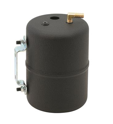

If you have good vacuum at idle you might try a new check valve or a vacuum canistor that would provide a second check valve
http://www.summitracing.com/parts/MRG-3701/?rtype=10

I am getting 10-12 inches at idle. When I run the RPMs up in 2nd or 3rd and let off I get about 20 inches of vacuum and the brakes seem to work much better. I did order a vacuum canister and will see if it makes any improvement.

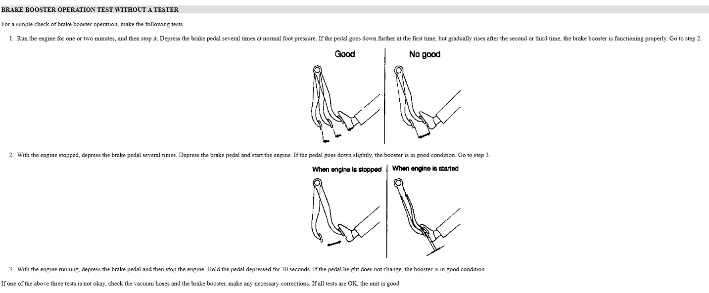

Here are some tests to perform on the brake vacuum booster to see if it is operating correctly:
I added a vacuum reservoir can and it make a pretty nice improvement. Much better pedal feel.
