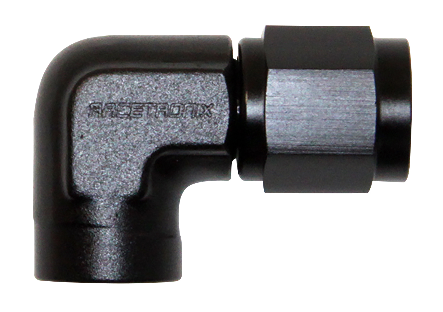

I also had another question with regards to mounting my fuel pressure gauge to the fuel rail. I purchased a liquid filled gauge so it is OK if it does eventually go on me however it is nice for the meantime while it to the car and I’m just gonna leave it on there. But I’m not exactly sure how to mount it, i’ve heard lots of people doing different things but I want to do it right. I did see that there is a Schrader valve on my fuel rail and wondered what I needed to mount it to that properly. Like what are the fittings called exactly? Are they SAE? JIC? Or some other special fitting?

Other than if you just like the looks of it, a rail mounted fuel pressure gauge is only good for setting idle fuel pressure (which you really won't fiddle with very often once set) and they also tend to be inaccurate anyway. It can also become a source of leaks which could start a fire. However, if you must have one, if memory serves its a 1/8" NPT. Most FP gauges require removal of the schrader valve, although Kirban sells one that can you can leave the schrader valve in.
Casper's sells the fitting too. Just don't use one of those colorful red black or blue fittings made by Earl. They leak in no time.

Never been a fan of the well known adapters.
The only adapter I think looks and works like a champ is from Racetronix in the link below. Don't let the fact that they are in Canada deter you. Their shipping rates are very competitive.
