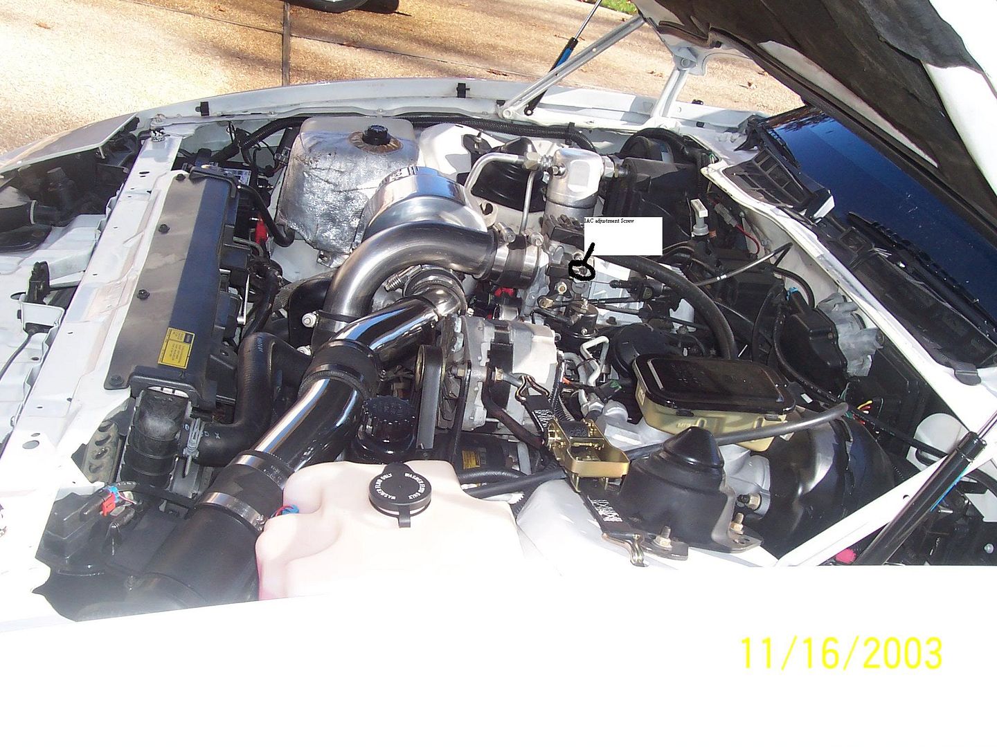

3. Nothing has to br grounded. The IAC adjustment is on the drivers side of the motor in front of the FPR.

Installing the scanmaster is a breeze. Comes with great instructions. Yes, IAC-Idle Air Control...should be 5-20 at hot idle. DO NOT mess with it unless you have to. If the car starts and idles fine leave it alone. Dont ask me how I know.... :eek: . You dont disconnect the IAC. What chip do you have? Most and all chips have the idle at 700-800 rpms. I wouldnt really worry about it unless it is really high. Sorry for the choppy reply. I was reading then answering. O and I dont really remember how I blocked off the throttle body coolant line. Someone who remembers chime in.
