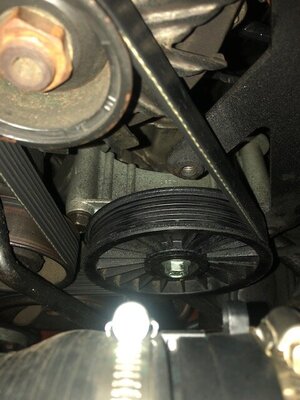

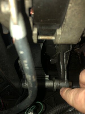

Hey Nigel, do you have pictures? That would be nice for this old amateur to see.
First picture shows the delete pulley installed using the bolts that formerly held the condenser in place. Second picture shows me pointing at the 2 washers per side I used between the delete pulley bracket and the mounting tabs on the engine. The alternator is the item at the top of both pictures.
That fits perfectly
