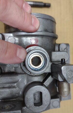

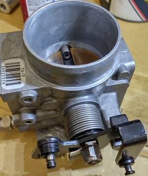

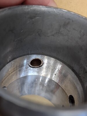

Gotta do it yourself 🙂 Dear ole Dad and I just put alot of time and effort into fixing the shaft play on my stock TB. It took custom made bushings with correct tolerances to address the wore out TB housing. If you have ever smoke tested your Turbo Buick... Many times the TB is the source of your vacuum leak.

Steve used same seals gbody sells. Issue with those seals.... They are roughly .025 too large on the OD of seal. The bore needs to be opened up or 1 of 2 issues may occur. Seal is destroyed during installation or you may split/crack the TB housing. In regards to the seal only replacement....The repairer should check the end play for wear, if you can move the shaft back and forth, that needs addressed otherwise it will destroy your new seals in a short period of time. I looked at about 6 stockers and they all needed bushings prior to seal replacement to get the desired outcome. If you can find a low mileage piece, that would be way to go.

Exactly, that is how we repaired it. Having a Bridgeport in the garage makes it nice:) But it is still a time consuming job. Machine shops bill on hourly rate. Most folks will by an Accufab due to cost and figure out it needs repair eventually as well. I tried that route. Time is money but better to know it's right. I can't believe the improvement after installing on the car, and it's just a stock piece. I have a 62mm up next. It needs the same bushing repair as the stocker but wanted to test it out on a piece I wasn't worried about scraping.
