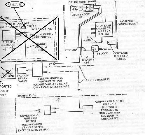

Here is illustration from shop manual ... doesn't show anywhere what wire does what ..... I will confirm the connector, but I am pretty sure they are same.
  • TCC 80 vette.pdf
I knew the ~'80 GM models had peculiar parts like Q-jets with TPS but no ECM and non-ECM switched TCC circuits in the early 200-4Rs. But that's pretty interesting in the TH350-C how they made the TCC work based on speed vaccuum and temp with no ECM. I'm laughing here.
The bottom line is that your TCC is going to work off of the same voltage. They used that gov. pressure switch to avoid low speed lockup drivability problems. That could be accomplished in other ways such as a VSS source & a switching setup of some sort. If you're deadset against an ECM at some point I'd consider adding the gov. pressure switch to the 200-4R but I'm not the guy to tell you whether the 200-4R has a tap into that circuit. The rest of the wiring will work fine; short of perhaps a physically different plug and that's easy enough.

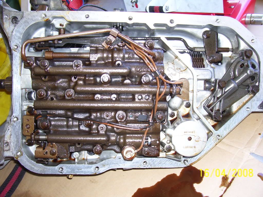

Since I have a 4BQ valve body and it IS different from non-GN valve bodies that I have seen so far, in that my vb has TWO pressure switches, is that for 4th gear lockup or something totally different??
Here is picture, if that helps any .....

For what it's worth, here are the wiring configurations for all 1987 model 200-4R's. Most other years are similar.
If you want to save yourself the $95, do like I do when I build one for non computer use. I run a 1 amp fuse from Key On source at the fuse block to "A" pin on connector to the positive side of the solenoid. Run the negative side of the solenoid to the 4th pressure switch and it will lockup automatically in 4th. You can interupt the ground side and add your own switch to ground and make it lock up when you want. Solenoid receives 2nd gear oil and has the capability to lockup at that time. Never had any problems in the last 20 years building them like this and I just don't lockup the stock type converters at WOT with this set up.

I have the lower left vb, with the two pressure switches ..... and planning on using an ACC 2800-3200 Street Bandit TC.
So I guess I will remove the lone wire coming down from my vacuum switch to the Th350C now? I think it must have 12v switched, but could be wrong!
