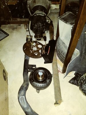

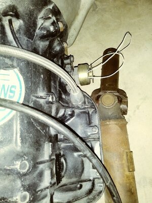

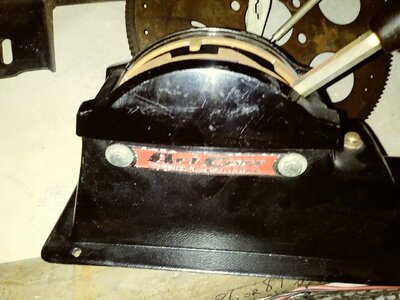

Got it thanks.i have the option for both got this 400 with everything it was already in a grandnational just needs gone through.

Keep the 2004R
The 400 WILL absorb more power than the 2004R.
The 400 is NOT needed on a Hot Air car, especially a stock one
there will be people all over that like a Duck on a bug making big power.You have all the trimmings to put a 400 in his GN. Nice but not needed in your car.
