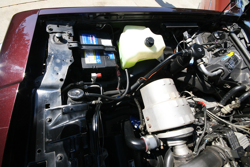

When I bought my T the guy told me he converted it to 134. Is there any way I can tell by looking at the unit under the hood to see if it's actually converted or not?

Look at the fittings. 134-A have quick connect charge fittings and the caps are usually larger. Look at the low side because I have seen people that don't change the high side connector and evac and recharge through the low side only. 12 fittings have the cap threads on the outside of the fitting while 134 in internal.
Two of mine that have been converted both have the same sort of fitting on the PS line next to the battery. You can see it with the red cap in the picture above. Original R12 cars have no fitting at all on that line. HTH.
As far as I know, that car has been converted too. Others can chime in if I'm wrong.
I hope so but I do not see any quick connects. It does look very similar to you're though.

I have the same question for my car :mad: : R12 or R134?
What I do know is that the quick adapter fittings can be removed after charging. What that means is that the car can in fact be charged withh 134, and the fittings removed.

looks converted to me. unscrew the plastic caps: if you see only threads, then it's R12.. if they look like bigger versions of the quick disconnects on your air tools, then it's R134..
