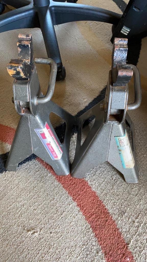

I have had these stands a long time. They are not the same brand but I bet they came from the same Chinese factory as they look identical. The catch paw on these looks long enough.
