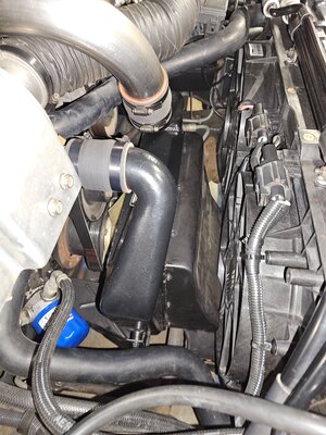

I have attached a picture of the new aftermarket aluminum radiator and a picture of the Chevy Volt fan on the original GN radiator.
