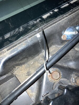

I went out to my son's house and snapped this picture. It is under the (removed) cover at the base of the windshield. In this picture you can see the wire coming from the windshield, The new windshield went in as part of the restoration several years ago. I don't listen to the radio, so I never hooked it up. I think I remember that there was a connector at the end of the wire then. It must have broken off. You can see just to the right of the wire the plug it has to be connected to. This leads to the radio. So I need a way to get those two together.

I believe what you want looks like this. I'm not sure where you'd be able to find one unless you get it off another windshield.
Maybe try stopping off at places that do windshield replacement.
I think that is the way to go. Such a simple piece that I need. Somebody must have it
That blue wire is a coaxial cable with outer braid and inner conductor that is molded or crimped onto the wire.
If you get one get one with some wire on you can spice into yours, it won't be optimum for signal strength but it will work.
I doubt they make a replacement connector end for that cable but it's worth looking for.

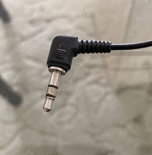

I may have come up with a solution. I found an old set of cheap headsets for my old iPhone that had a connector. see picture. The male plug looks like it might fit into the receptacle on the firewall. And it is conveniently a 90-degree connector. I will give it a try when I get over to the car next time. Here's hoping. If it fits, I can just snip it off the wire and splice it to thepin.jpg bare wire hanging from the windshield.
UPDATE: I took my car to an audio expert. He confirmed that the wire coming from the antenna in the windshield is NOT coaxial. This had him baffled until he tried to see what happens if you just insert the bare wire into the firewall connector leading to the radio. Much to his surprise, the radio came to life and played clearly. Pull the wire out and back to just static. Now he is trying to find a pin connector that will fit in the cable. 3.5 mm too big, 2.5mm too small. We need to find the goldilocks pin. I think we are going to be successful on this.
